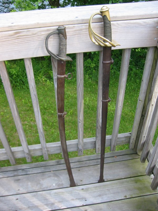

Many cutlass types were quite straight. Many land forces continued to field both straight and curved blades through WWI and into WWII. Patton took one from column A and one from Column B when "designing" what was approved by the U.S. Ordnance in response to European trends dating back some decades to make straight swords the universal fit (and their continuing to field curved blades along with them). U.S. adoption of trends and specific model types during the nineteenth century were generally a couple of decades late in widely using them. the U.S. went backwards in the 20th century to re-issue their mid 19th century sabre (there really was no 1860 but there was a 1906 designation). The Poles carried their 1934 curved blades into the beginning of WWII, with other countries also actually carrying curved swords with mounted troops. Nickel plated Patton swords were being carried and trained with in Peking by the U.S. Horse Marines until displaced by WWII brewing.
The truths, misconceptions, myths and disinformation can easily fill large volumes of text.
Didn't some European hussar troopers simultaneously field both poky straight lance substitutes for the massed charge and curved swords for melee? Oh ya, French lancers with armour used into WWI as well
GC

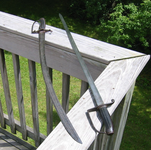

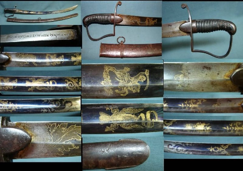

Hi Johan,
I am a bit puzzled by your post and the differences between truths and what becomes confused. The two 1796 patterns being discussed previously in this thread are both British patterns and written of at length in the above linked article penned by Martin Read. Please do take a long read of that page for a good start in understanding more about history instead of Cold Steel and their poorly thought out ad copy. The article linked and written by Read is quite well done and researched. Lynn Thompson and his Cold Steel ad copy is not, despite his "wow" videos. Many of his sword designations are simply wrong headed, such as his Napoleonic 1830 sabre. Think about that Wink Really, think about that Wink ?8^)~
The British 1796 light cavalry sabre is absolutely not based on the Indian Tulwar
http://swordforum.com/articles/ams/cavalrycombat.php
American use of the British patterns went hand in hand with both the 1796 British LC sabre and the straight British 1796 heavy. However, there were contemporary contracts by makers such as Rose and Starr that grew in American arms use. I do have a couple photo examples I can share of both an Americanized sabre and the straight heavy blade but picking up a couple of books regarding American sword growth and use may be of great benefit to you. Peterson's American Sword, 1775 to 1945 is still considered a good basic bible you can pick up inexpensively and while dated, as is Neumann's Swords and Blades of the American Revolution are two great beginnings for not just American swords but those appearing from England and the European continent. Scandinavia as well fielded what is essentially the British 1796 LC as well.
Anyway, those two types used in America but of British origin. Another great picture book and quite well cataloged is the Medicus Collection of swords used in America over a couple of centuries. That by the younger Stuart Mowbray and Norm Flayderman. www.manatarmsbooks.com/
It is just sad to read the bad information repeated time and again without a thought about the real information just a click away.
GC
 Attachment: 108.09 KB
American grafitti
 Attachment: 119.85 KB
Not as pretty an eagle as the Mowbray book example but representative of an Americanized British 1796 heavy cavalry sword.

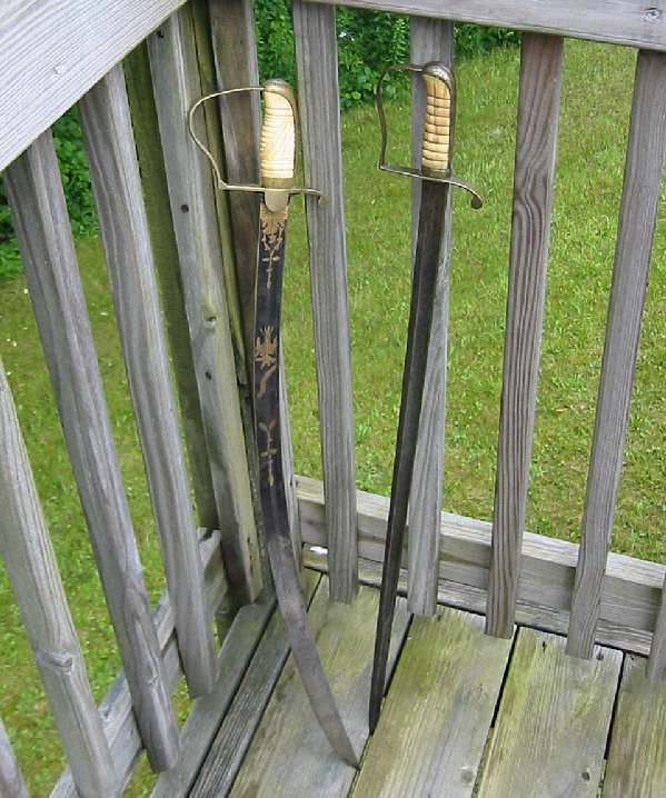

Another pair of thought from the late 1780s but patterns that went back a quarter century or more before that. Edit to add that some may note a trend in my own collecting and the thoughts of thrust vs cut over the decades and centuries Laughing Out Loud
GC
 Attachment: 72.25 KB
Two British pattern infantry types. One straight, one curved.
Last edited by Glen A Cleeton on Fri 12 Nov, 2010 5:01 pm; edited 2 times in total

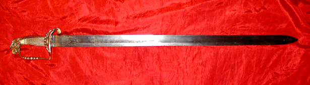

Glen A Cleeton
Location: Nipmuc USA
Posts: 1,979
PostPosted: Fri 12 Nov, 2010 4:55 pm    Post subject:         Reply with quote
Move forward again to the 19th century and we have here a pair from American use of quite similar proportion and purpose.
 Attachment: 123.4 KB
Berger sabre and Spies (New York, see Wolfe) retail spadroon both common patterns but of Solingen and Austrian make
