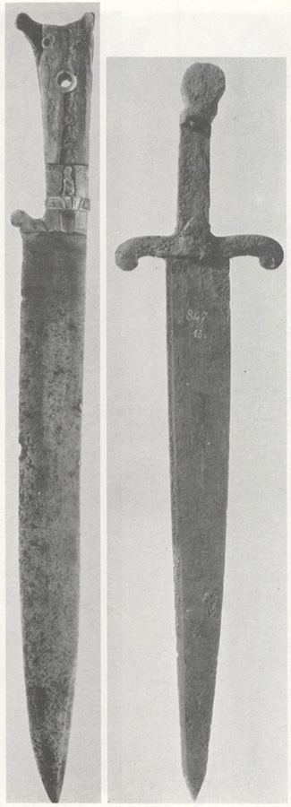

Does anyone have any information or thoughts about Bauernwehr-Hauswehre with quillons?
Over the last few years I've come across a lot of photos of original and replica Bauernwehr, but I've only ever found two photos of Bauernwehr with quillons.
The attached photo is from the book "Daggers and Fighting Knives of the Western World by Harold L. Peterson".
In the book Peterson dedicates half a page to "Peasant Knives (Hauswehren)". He only mentions those will quillons very briefly but stating "Some Hauswehren had quillons (Plate 43)."

Hi Danny, This is a question that has interested me too, ever since seeing that photo in Peterson ... a Bauernwehr with quillons and a false edge would be fairly close in profile and handling to a Bowie, which I find intriguing.
Anyway, I've just had a quick look through Europäische Heib- und Stich- Waffen by Hartmut Kolling and Heinrich Muller, and did not see one, so that strikes one possible source off your list. (They do show one with a fairly substantial curved lower guard, but not full quillons.)
However, I don't read German, so not sure if they say anything about this question or not.

PostPosted: Fri 14 Jan, 2011 2:57 am    Post subject:         Reply with quote
Below is the image from Peterson, so you don't need to download it.
I have a question: from the shadows / changes in colour, and from the profile on the right hand side, does it look to anyone else that this one has both a nagel as well as those quillons?
Danny's scan shows it a little, but checking the original in my 1st edition of Peterson shows a clear strip of reflection on the left hand side where it looks like the nagel is, as well as a less distinct reflection below this, near the ricasso, where the base of the nagel would be.
While this might not be common on many knives throughout history, it does make sense from a defensive / weapons use point of view. One of the best examples of modern thinking and design in this regard is James Keating's Crossada (that has a downward-curved crossguard as well as ball-terminalled cross-quillons), as well as the slight diamond-shaped flare on the sides of the crossguard on Bill Bagwell's Hell's Belle Bowie - these flares are very subtle, but are enough to catch an opponent's blade if they try to run down the length of yours.
Anyone else see a nagel here, or is it just me?

PostPosted: Fri 14 Jan, 2011 3:45 am    Post subject:         Reply with quote
Mark T wrote:
In the original, do you think this text means that the quillons do not belong on the Bauernwehr, or could it mean that the by-knife and pricker do not belong with (ie make a 'set' with) the Bauernwehr?
I'm not a native speaker, but to me the text is quite clear:
Eines mit Beimesser und Pfriem = One and with by-knife and pricker
und = and
eines mit nicht zugehöriger Parierstange und Stichblatt. = one with quillons that do not belong to it

PostPosted: Fri 14 Jan, 2011 4:19 am    Post subject:         Reply with quote
What Paul said. The description encompasses four different knives, not including the by-knife. Ein or eines (a, one) denotes the next knife. See the picture in the first post.

PostPosted: Thu 17 Mar, 2011 10:01 am    Post subject:         Reply with quote
I don't have anything new to add, other than theory about why the quillons may have been "added" to the one knife. Given the date range that it has been placed in, the knife may have had quillons and/or side-ring, since to me it more resembles a side-ring instead of a nagel, added to it in order for the weapon to function as a parrying dagger. The nagel already functioned in in a similar manner to a side-ring, just add quillons, and you have a cheap solution for the need of a parrying dagger, without having to buy an entirely new weapon.
Hurray, practicality!
I'm pretty sure I see the nagel on the second example as well, Mark.
