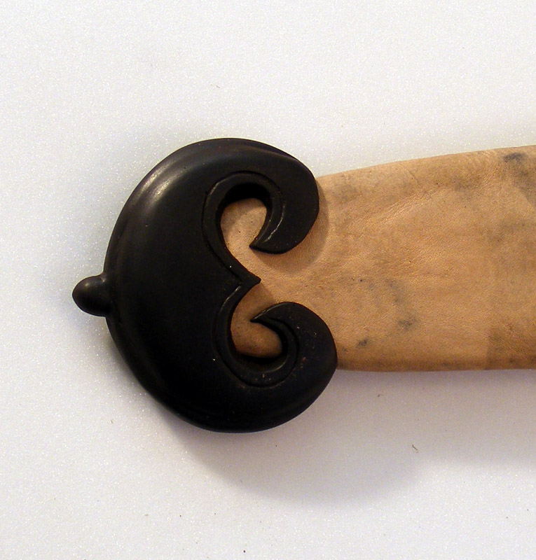

PostPosted: Tue 18 Jan, 2011 1:02 pm    Post subject:         Reply with quote
Hi All,
The guard is at the casters being moulded so I am told 3 weeks, which means 4.........
I have also made the master for the scabbard chape and I will work on the eating set this week, so maybe some progress pictures as that develops.
The master for the chape is made from a modelling resin and will now be sent away fro lost wax casting in bronze.
I hope you like it.
Tod
 Attachment: 165.54 KB
 Attachment: 170.98 KB
www.todsworkshop.com
www.todcutler.com

PostPosted: Tue 18 Jan, 2011 1:14 pm    Post subject:         Reply with quote
This project is really cool Tod! I love the chape. Seems so simple but I know it wasn't. I have the laugh at the guard, I know it will be curved later but it just looks so funny being that long! The pommel looks great too! Can't wait to see this one finished...

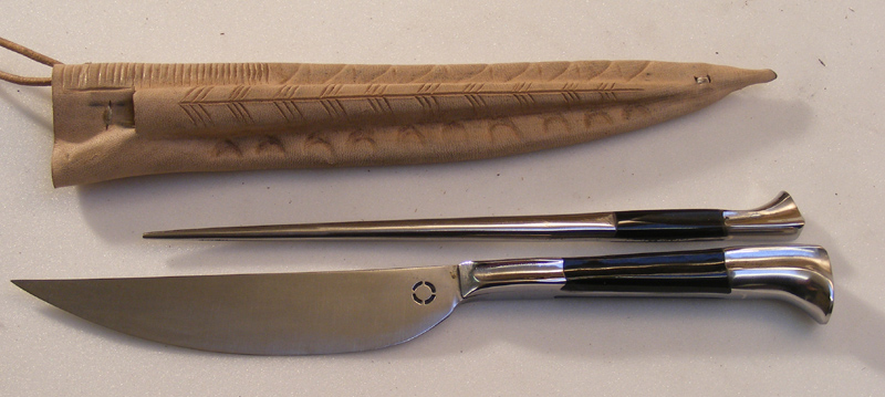

The guard, pommel and chape are at the casters and so I started on the eating set, which I need to do before I start on the scabbard as they also need to fit into this as well.
I have opted to take the detail of the pommel of the katzbalger and so make a set of three items. The knife and pricker would have been odd if they had the full fish tail pommel, so I opted for a half pommel form. The two items would also have been out of proportion if they had the same size pommels so these are the reasons for these choices.
The scabbard for the eating set is not so ostentatious and just has some simple decoration incised and pressed in. This will lift out far more when the piece is dyed and polished.
