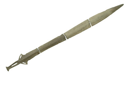

Does anyone know if anyone makes replicas of European Bronze Age "leaf shaped"swords ? Out of bronze ( not brass) , naturally ? I've always liked the look of these weapons and I'm curious to see how well they performed. The following pic is something along the style I was refering to.
Attachment: 8.93 KB
The first to spring to mind is Neil Burridge... He even seems to have a replica of a very similar sword to that which you were showing on his page:

I had thought of going the "Make your own Mould" way, but ran into a few problems. Here, down in Australia, there seems to be a death of genuine Bronze Age swords for reference work. It's easy enough to find plenty of pics, but that doesn't give the full story- blade thickness, weight, etc. I figured that someone in Europe who had more 'hands-on"access to genuine swords would be better placed to produce a good replica.
As I promised this is my latest bronze casting. A nice bronze sword.
It is 43.5 cm from point to pommel tip. I am going to inlay ebony and ivory into the grip section.
There will be no hurry to complete this, why make a mistake?
The black spots on the blade is not porosity. My castings have no porosity. Those marks are from ammonium sulphide spill. Ammonium sulphide (NH4)2S is use for patina. A hard black patina on bronze.
