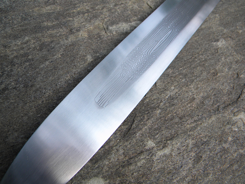

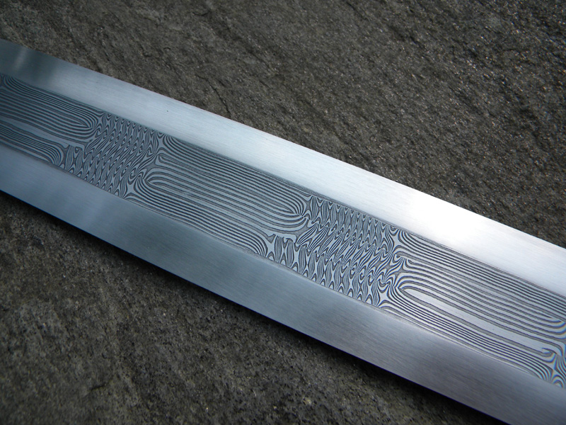

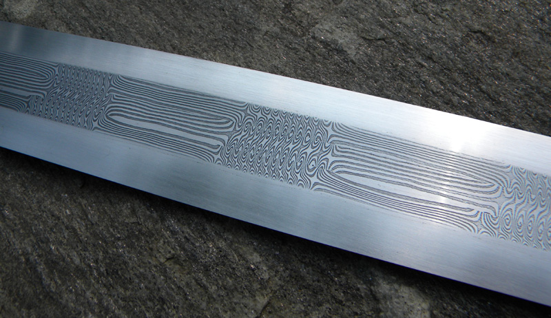

Last night I finished up a project that I've been working on for sometime, and I think the results speak for themselves. This project had a whole lot of firsts for me, and really forced me to work with what I had and continue rolling forward. The core of the sword has three bars with interrupted twists, I came up with a tool to help me do the twists fairly easily and while it worked well, the spacing is off if a few places but some more tweaking and the next one will be better. The steel edge was welded in the same heat as the core so 5 pieces went in, and came out as one, and the tip was welded using a special trick and technique that I came up with and turned out exactly as I wanted it to. There are no welding flaws in the blade, everything is 100% solid, there is one little pit that I didn't grind out, but I don't feel that it really distracts from the blade, and is where one of the twists and the core created a tiny little pocket, literally the size of the tip of a fine pen.
I miss estimated how much the material would compress during the welding and forging process which left me with a blank that was a touch on the thin side, so I used a fullering tool to widen the blade, and then forged in my fuller and edge bevels. Since I was trying to gain as much width as I could the pattern in the twists distorted more then I would have liked to see, but I think it still works and is attractive in it's own special way:) Due to getting the blank so close to final size while forging, and the cleaning up the scale I was pretty close to my final dimension when I went to heat treat the blade. Which is a good thing, and a not so good thing at the same time. When heat treating blades that are super thin, and especially ones that have twisted pattern welded rods in them, the blade like to go crazy and twist and distort. I was able to get the blade back to really close to being straight, but there are a few places that the edge wanders. This is mostly limited to one side, and is below the area that would have been used from cutting, and overall the blade is as straight as the handful of originals that I've gotten to handle. On the curious side of heat treat as well is I got some splotchy hamon activity on some areas of the edge, mainly the tip, but not on others. I did a file test prior to tempering and the whole edge skated really nice, and I did a brass rod test after honing and the edge held up fine. The aesthetics of the hamon didn't show until after I had my final finish on the steel.

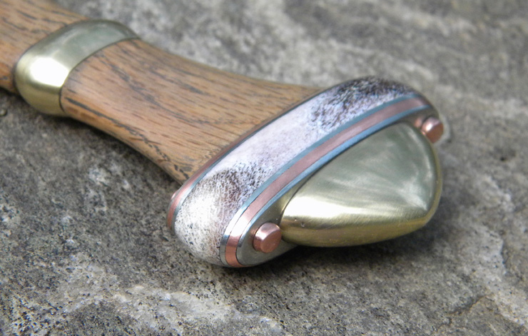

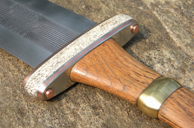

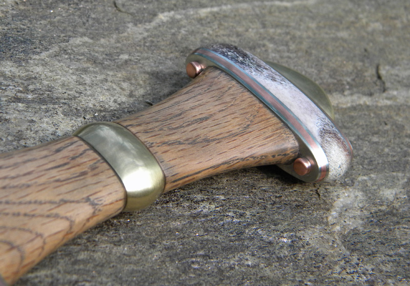

The handle was loosely inspired by an image that a member posted a long time ago on here, and I thought that it would fit the blade, and due to the "simple" nature it would make a good first attempt at building this kind of hilt. I decided to make a layer of nickel silver, copper, nickel silver, to encase some antler on either side for the guard and upper guard. Then I chose to contrast the coloring with brass for the bead in the grip, and the pommel. It was an interesting process to say the least, and I think it came out looking pretty good. I chose Oak for the grip, I could tell from the original that it was most likely exposed wood, so I ran with it and was questioning all the combinations until it all came together.

Secondly, the deer antler you used, is the speckling on these sections the 'honeycombed' inner core of the antler, if so, does it feel textured and porous or have you, in the process of polishing, essentially filled in the holes and pits in the antler texture?
