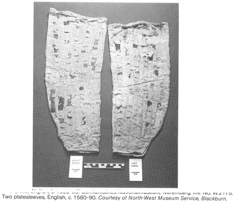

From an The journal of Arms and Armour Society article on Jacks and Brigantine 1989.
would appear to be a cloth sleeves with jack style plates in channels
The image is quickly cut and pasted out of a larger scan.
 Attachment: 132.06 KB
 Attachment: 26.48 KB

PostPosted: Fri 08 Jul, 2011 10:23 am    Post subject:         Reply with quote
Looks kinda like the plates from a Japanese kote sewn inside of the sleeve.

PostPosted: Fri 08 Jul, 2011 1:55 pm    Post subject:         Reply with quote
Exactly what I was after. Many thanks. Which museum are these in?

PostPosted: Fri 08 Jul, 2011 11:48 pm    Post subject:         Reply with quote
Are there any plates in the elbow section?

PostPosted: Sun 10 Jul, 2011 10:13 pm    Post subject:         Reply with quote
I am only guessing based on the image I would say yes.

Ian Eaves, “On the remains of a jack of plate excavated from Beeston Castle in Cheshire,” Journal of the Arms & Armour Society, Vol. XIII, No. 2 (1989) wrote:
p. 88 "The only other explanation which seems to suggest itself for the function of the oblong plates found at Beeston Castle, is that they may have formed part of a pair of arm-defenses worn with the jack. ...Two surviving jacks of the third quarter of the 16th century still retain such sleeves.[68] The sleeves (Plate XLI-B) are of fairly voluminous form, shaped to the elbows, and constricted at the wrists. They consist, like the jacks themselves, of iron plates sewn between two layers of canvas. The plates are of oblong form, about 5.5 cm long and 1.6 cm wide, with cropped corners and a single central hole for the stitches. The outside of each arm is protected by five columns of overlapping plates. Each column is separated from its neighbours by a gap of between 1.5 to 3.0 cm, according to its location. The columns are broken only at the elbows where a separate gusset in the fabric of the sleeve is covered with four or five columns of smaller plates of the more conventional, square type, to give greater flexibility. The smaller plates also occur, in one instance, at the wrists: for the same reason. The insides of the arms are protected either by two short columns of plates protecting the forearm only, or by a single, full-length column at the fron, broken only at the elbow. The tops of the sleeves are provided with lace-holes so that they could be tied either to the jack itself or, more probably, to the garment beneath it.[69] The cuffs, which are split at the back to permit insertion of the hands, are also provided with lace-holes. The plates from Beeston Castle, although similar in length to those occurring in the platesleeves just described, are, in most instances approximately twice as wide as them, and pierced with two holes instead of one. it is nevertheless that other patterns of platesleeves than those recorded were produced ..."
Plate XLI-B is labeled "Two platesleeves, English, c. 1580-1590. Courtesy of North-West Museum Service, Blackburn."
[68] Preserved in the collections of the North Western Museum and Art Gallery Service, Blackburn and the Royal Armouries, H.M. Tower of London, No. III.1885. respectively (see note 29 above).
[29] ... Another of similar date, retaining its plated sleeves was recently acquired from the collection of Mr Edward W. Budde Jr., Amityville, New York, for the Royal Armouries, H.M. Tower of London, No. III.1884. A further jack of the same pattern, also retaining its sleeves, together with another, lacing down the right of the chest and lacking its sleeves, was lent by the late Mr John Forrester to Rufford Old Hall, Lancashire, and is now in the care of North Western Museum and Art Gallery Service, Blackburn. These formed a part of the ffarington collection at Worden Hall, Lancashire, which was dispersed by auction in 1948. An inventory of the collection, purchased at the sale by Mr Forrester, former manager of the Worden Hall Estate, is now in the possession of his son of the same name, at Maudsley Hall, Lancashire, and shows there to have been three such jacks in the ffarington collection in the 19th century. The third is very probably that now in the Royal Armouries ..."
