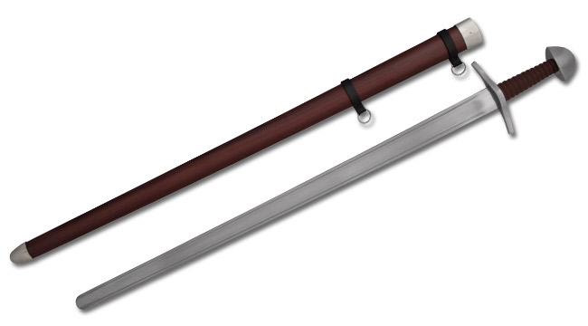

heres my sword it possesses a tea cosy pommel.
that said,as i bulk up the grip, im finding the sword easier and much more manageable to swing, bare handed, but when i grab the sword in my gloves, which are leather gardeners gloves so arent exactly snug on my hands, the gripping becomes if anything more difficult.
so another dimension to whats comfortable might actually be the diameter of the grip which determines how it fits in the palm.
but ive been advised with such a large pointed pommel to not try and wrist fllick because its actually a fraction too big for my hand. ungloved its a tad too SMALL for my gloved hand.
Attachment: 21.47 KB
hanwei practical norman sword length of the grip is exactly 10cm/4 inches.

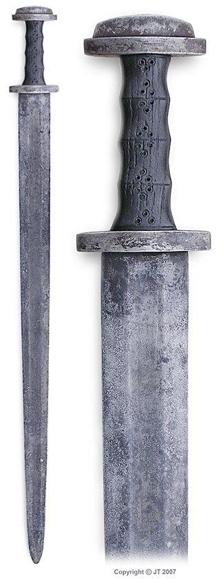

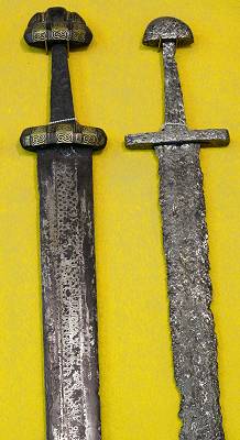

I think (opinion of a nobody) that the smaller grips were used for a variety of reasons, not the least of which could be 'if it works (and it must have), then why change it?' Cultural impacts and local styles might influence later developments, but many of the raiding cultures have short, smaller guards and hilts, with cutting style blades.

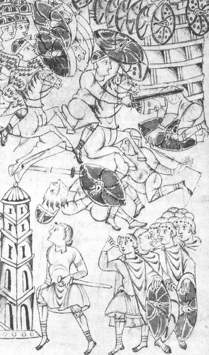

Attachment: 18.57 KB
sword on right is carolingian
Attachment: 73 KB

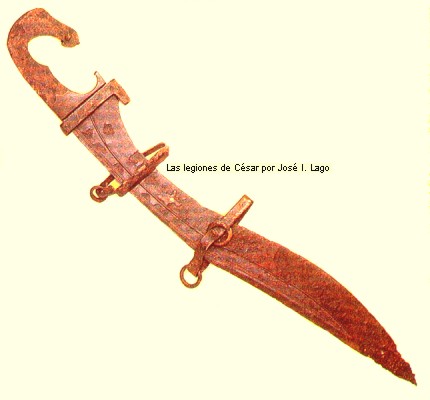

Iberian falcata
Attachment: 111.31 KB

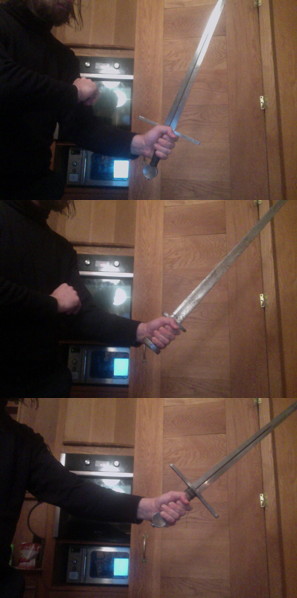

I've tried to illustrate what I mean in the three pictures below.
Pic 1 - Hammer Grip. Pure and simple.
Pic 2 - Cut with hammer grip; note the grip still isn't quite in the handshake position, I've merely allowed the pommel to slide by my wrist; it didn't start in that position and the grip hasn't altered.
Pic 3 - Handshake (pistol) Grip. Completely different if subtle, makes for too weak a grip in my humble opinion.
Attachment: 208.88 KB

Timo Nieminen
Posted: Wed 19 Dec, 2012 3:17 pm Post subject: |
Neil T wrote: |
Pic 3 - Handshake (pistol) Grip. Completely different if subtle, makes for too weak a grip in my humble opinion. |
OK, a difference in terminology. I (and many others) would call pic 2 "handshake" - the heel of the hand is beside the grip and the grip is diagonally across the palm. From the finger position, I see why you call it a hammer grip.
The grip on your sword looks very long for a viking. Consider the same transition between grips 1, 2, and 3 (whatever one decides to call grip 2) with a sword with a shorter grip. If, in grip 1, the hand fills the space between guard and pommel, the transition to 2 requires a bigger change, basically a change to an undeniable handshake grip. So, with a shorter grip, one has the choice of either staying in the locked in place by the pommel/guard hammer grip and missing out on reach, or switching to a handshake grip.
The locked in place by the pommel/guard hammer grip is super-secure, even with a relaxed hand, since you get plenty of support from the hilt.
I don't find grips like your grip 3 insecure or weak. It's a standard sword grip in Japanese sword arts, and elsewhere. Note that the 3rd and 4th fingers are opposing the base of the thumb - these fingers should be providing the main strength in the grip; the 1st and 2nd fingers (index and middle) can be relaxed. This is not the same as the pinched between thumb and finger foil/epee grip. I think you are entirely correct when you say a thumb and finger pinch-grip is too weak for a heavy weapon (heavy compared to a foil). The difference is whether it's the thumb-and-finger holding it, or the palm of the hand holding it.
Can you hold in your grip 2 for a long time? It looks like you are holding strongly with your 1st and 2nd fingers, maintaining hammer-grip fingers in a more handshake grip sword position. Relaxing 1st and 2nd fingers, and gripping more with 3rd and 4th would naturally take you to position 3, which I find is comfortable and secure. As a brief transition while cutting, staying there isn't much of an issue per se, but it might say something about the strength and security of the grip.

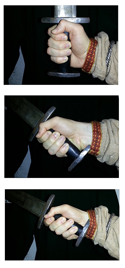

A little while back, I attempted my first sword mod; converting my cheap polish viking sword to a more historical grip length, and removing the upper part of the pommel. The result was a sword with a grip length of 9,5cm.
And this sword, when held in hand, automaticaly ended up in Peter's "handshake grip". And consequently, my stance, guard and figting style also change.
But I can not replicate this in an usefull way with my other swords.
If your sword is made for it, it will happen all by itself. If not, it does not work.

Elling Polden
Posted: Fri 21 Dec, 2012 2:49 pm Post subject: |
Here is a quick series of photos illustrating the point above.
First one is a regular casual grip of a medevial sword.
Next, a casual grip on a viking sword with a 9,5cm grip.
Finally, the medevial sword held in the same fashion as the viking sword.
As one can clearly see, the viking sword is angled significantly more forward. This is because the pommel effectively rests iINSIDE the hand, and becomes the index point of your grip. On other swords, you place your hand in relation to the crossguard. Here, you place your hand on the pomell, and the length of the sword grip is adjusted so that your hand will fit propperly.
As the last picture shows, this does not work at all with a medevial sword, or a viking reenactment sword that has a grip lenth of more than 10 cm.
As such, all comments from reenactors that find the grip upractical are all perfectly valid. It is question of sword design.
As such, the term "handshake grip" is quite misleading. It should be termed "Pommel grip" to avoid confusion.
