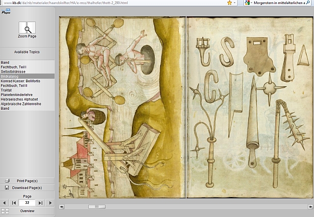

this would be hilarious! Happy Well, Hans Talhoffer (* ca. 1420; † ca. 1490) obviously knew the handy flail with spikes. It's not a ball, but spikey enought for my tastes. Have a look:

 Attachment: 219.26 KB
James Head
Joined: 09 Mar 2008
Posts: 127
PostPosted: Tue 10 Jan, 2012 1:24 pm    Post subject:         Reply with quote
Hi Thomas.
The weapon in the lower right hand corner is most definitely a two handed 'war flail' like what the Hussites and other peasant armies used.
First, and most importantly, none of the objects illustrated on this page of Talhoffer's 'Thott' manuscript are anywhere close to being to scale. You have very large weapons placed next to much smaller hooks and hinges and straps etc...
Taking a closer look at the war flail, you can see a roundel located down by the lower third of the weapon's handle, which is a method of hand protection consistent with other pole weapons of the time. Also, the flail head is the same shape and size as other two handed flails (just look at Paulus Hector Mair and Jakob Sutor). FInally (and this is the best evidence that you are looking at a big weapon) there is only ONE free chain link connecting the head to the staff. This short style of band creates a powerful snapping motion, nothing like the long wavy chains of the single handed version (which I don't think existed at this time anyhow).
P.S. The object on the left hand side is a little more mysterious, but I'm pretty confident it some type of scourge or cat-o-nine tails: leather thongs with nasty thorns woven into the ends.
