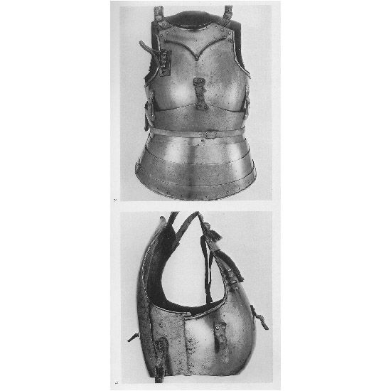

An example for an early style of back defence is the Churburg S 13 harness:
Churburg S13 is usually dated around 1390
(also see : http://www.myArmoury.com/talk/viewtopic.php?t...urburg+s13 )
The earliest original full backplate I found was from the Churburg S 18 harness (attachment)
I don't know too much about the conventional dating of this harness. I read somewhere that it might be a composite harness, but if it isn't, I would put it in around 1410-1420, based on the gauntlets which turn up around 1410 and the armet which is shown in the Pisani-Dossi MS of Fiore dei Liberis "flos duellatorum" also dating around 1410 afaik.

 Attachment: 33.82 KB
S 18 harness from Churburg
