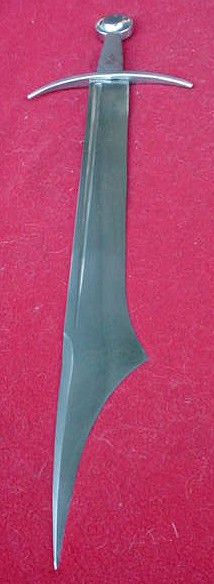

Hello I'm new to the forum and very excited to be here. Over the last couple years I've been a visitor and I would like to thank all of you who post in the forums for your knowledge and information. I would like to know if the Tinker Falchion would be effective against plate armor and or helmets, bevors or gorgets in regards to armor piercing or blunt force trauma transferrence. I've seen numerous explanations on this site as to why swords are not effective against plate when it comes to the cut or hacking attack because of a lack of concentration of force however does the "flange" or "spike" that adorns this sexy piece of steel negate that? On Tinker's website I read that most of the blades mass was efficiently focused on the spike much like it would be on a warhammer or mace flange, does this mean it would have similar effect on plate as an single handed axe or war hammer spike?

No sword is designed to cut armour but the point might be useful. Not against the plate itself but the point is needed to penetrate voiders and gaps.

Thanks for your speedy response Dan dumb question though, which point are you referring to I know that the high polar moment of the blade will make it an efficient thruster but I am wondering if you are talking about the point on the spike.

The side point is a little too obtuse of an angle I think, but the top point is quite sharp and would be able to find gaps.
As far as piercing plate, not really. It doesn't have the mass behind it. Possibly a very hard thrust with all your bodyweight behind it could partially pierce the thinnest and weakest section of plate.

The point does look very sharp, but one of the main reasons a warhammer spike is effective against plate is because of the momentum behind it. That's something a falchion doesn't have.

But I thought that the entire function of a falchion was to be have a high moment of inertia and more mass at the tip of the blade so that it hit with greater impact than other swords "axe like percussion" which is why it was effective against mail. Also this sword weight 2lbs 14 oz...but if it weighed say 3lbs+ would it have sufficient mass? I would think that this type of sword at least would have success transferring blunt force trauma especially if it was forged to balance like a axe mounted on a blade instead of a haft or a mace with one flange... with just enough counterbalance to recover.
It is effective agaisnt mail, but not because it can cut through it. It delivers more blunt trauma than a regular sword but blunt trauma isn't much of an issue with plate armour unless there is a lot of it i.e. mace, poll-axe, maul, etc.

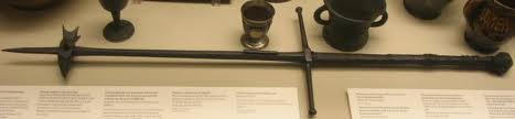

Ryan S. I agree about the math...I also think its a matter of forging and mass distribution of the blade itself. If this blade weighs 2lbss 14oz and if the majority of that is focused on the blade spike then why wouldn't it behave like similarly balanced weapons such as maces and hammers when they were of comparable weight. When Tinker described the weapon he said the majority of the swords weight was focused at the blades spike. I suppose my question should be would a sword shaped like the Tinker Falchion be effective as a blunt trauma anti armor weapon if it was forged to do so, with most of its weight centered on the spike. If the hammer below was made to behave like a sword...why cant a sword be made to behave like a hammer with the blade between the pommel and the spike and point serving as a haft. Keep in mind in a combat situation I would not target the breastplate...but the head and the neck, knees and ect...
 Attachment: 6 KB
 Attachment: 34.89 KB
