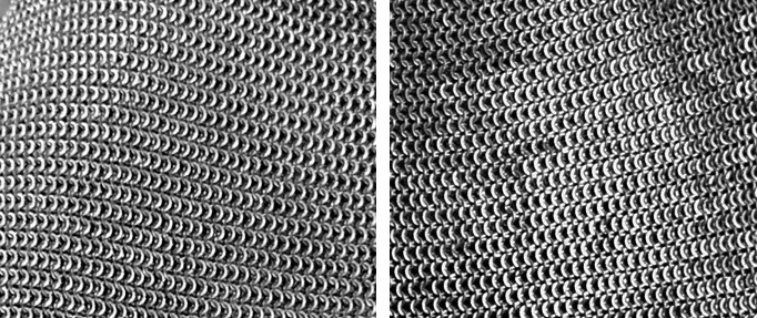

Just took a couple of photos of a patch of mail made of alternating rows of rounded and flat-section links. It shows the banding effect perfectly. The first has the light on the left showing the rounded links and the second has the light on the right showing the flat links.
Does anyone else have photos of regular mail that show a distinct banding?
 Attachment: 144.85 KB
Mail made of alternating rows of rounded and flat-sectioned links.

I made it from 1.2mm wire and some washers from Seastrom. ID is 4-5mm. The links are only butted - I was experimenting with smaller diameter links. It would take me a year to make an entire shirt from it.
Here is what it looks like with the light overhead. The banding disappears.
Um. I still see bands. Not as obvious as in the previous two examples, but I still can't avoid seeing the bands.

Likewise, particularly in the not-so-close-up version of the image on my PC. A full shirt made like this would be very distinctive and would certainly stand out next to 'ordinary' mail. Interesting experiment......

The further away you stand the more obvious is the effect. You see it on mail made of all the same link, too, but it needs the right lighting. For anyone who hasn't read it, I wrote about banded mail in the Arador article.

Hi Len, that's a good one. Another thing I've noticed is that when the links are bunched up, like that one, the effect is more pronounced.
