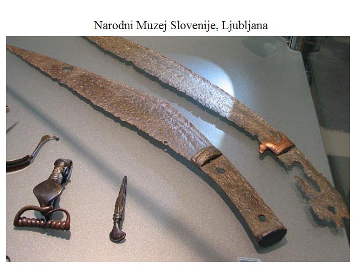

I'm curious matter of fixing cladding fighting knives with Celtic Thracian border, the period of La Tene, knives, a sica.
The museum in Ljubljana, the exhibits are two such "knife".
I put a picture.
Linings were organic (wood, bone, antlers), rivet holes are too large to rivets of iron, at this thickness is not so ....... zachwały the rivets were also organic?
We apologize for possible errors in spelling ...... I use the interpreter.

Thank you Ibor
Those are great examples of that type of knife.
The larger rivet holes maybe due to corrosion or they may have used tube rivets in addition to them possibly being a different material as you have pointed out.

PostPosted: Mon 06 Aug, 2012 6:15 am    Post subject:         Reply with quote

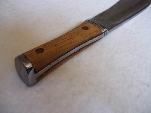

The holes in the two copies are too equal to this was the corrosion.
Tubular rivets, of course, used already in the Bronze Age in the example Liptov type swords, but they were of bronze, copper would be so preserved.
In my opinion, "rivets" were made ​​of wood and no trace of them was.
For this piece of iron hilt and head to just keep lining rivets front and back, gently, especially since they are also glued to the handle.

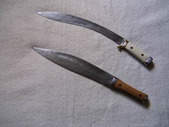

Recently just such a knife and reconstructed for the first time I used "rivets" wood.
Same pads were made of oak wood and rivets made ​​of beech wood, that was on the offensive with fat greater contrast.

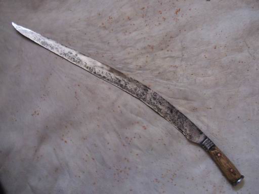

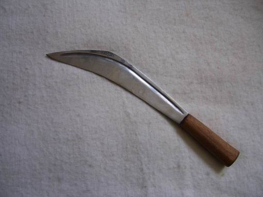

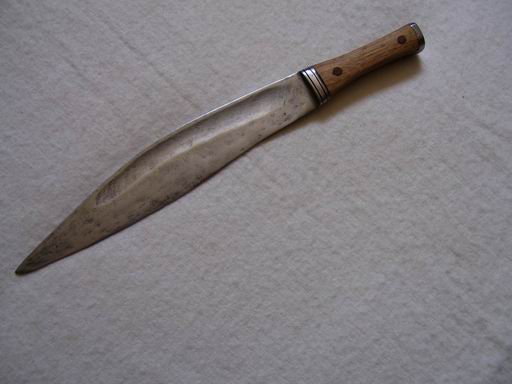

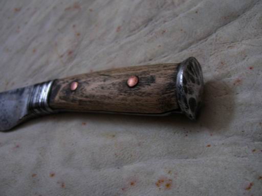

Scoot, I put some pictures of my Sic, together with that of the wooden rivets.
 Attachment: 31.47 KB
 Attachment: 31.58 KB
 Attachment: 32.2 KB
 Attachment: 33.92 KB
 Attachment: 32.52 KB
 Attachment: 33.33 KB
 Attachment: 28.18 KB

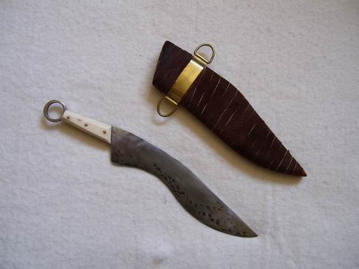

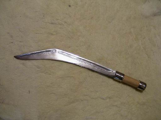

I finished the second Sica with pictures of zoomorphic hilt.
Linings made ​​of antler and rivets are made of beech wood.
 Attachment: 43.97 KB

PostPosted: Wed 08 Aug, 2012 5:35 am    Post subject:         Reply with quote
Thanks Stephane
"Horse" is riveted with two rivets copper, 2mm.
I am doing combed swords from the Bronze Age which gives pseudo rivets.
Mostly in swords Liptov type, dating to 1100 BC
Cast in its entirety and scholars two rivets, around which they are decorating.
