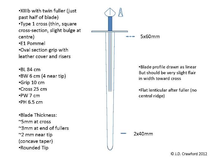

When commissioning a custom order, I like to make sure the Artist is just as passionate about the project as I am. So typically I have provided 2-3 ideas for a project and then let myself be guided by the reaction I get. The idea pictured below was somewhat overdeveloped –indeed a complete design- because it’s something I’ve been working on for several years. After seeing this design Craig Johnson, production manager at Arms and Armor, remarked:
‘The one you sent specs of would be a very sexy beast and I like it a lot.’ So that was it, we were both good to go.
Here’s a bit of background research on the sword. As a professional author myself I feel shy about repeating too much published material and scanning a whole lot of photos without permission, so this is just a summary with references for anyone interested in the details:
The original idea came from figure 56 in Oakeshott's 'SAC'. This shows a small drawing (from a rather obscure source) of a wide blade double-fuller sword with a ridged type E pommel. It was said to be from Hungary. Unfortunately only the upper half the blade is shown, so it’s hard to see how long the fullers go and the shape of the tip, but its visible profile looks XIII. The pommel seems diminutive for the size of blade, but otherwise I have long been intrigued by this sword.
The next thing I could find in the same ball park is Figure 849 of Nicole's ‘Arms and Armor of the Crusading Era’, which shows a mid 13th century sword found in Slovakia. It’s quite similar but has a single fuller and larger pommel. Nicole thinks it originating in Germany and, like Oakeshott, compares it to one of the sword sculptures in Naumburg Cathedral, which is mid 13th century.
The jackpot came with Aleksic's ‘Medieval Swords from South Eastern Europe’. He says there is a family of swords of this type, with XIII blades (often double fuller). He describes the pommel type as E1 on page 23, which is a more angular form of the classic E and usually has a central vertical ridge on each side. Pages 41-44 then go into much more detail of the swords. Table 7 provides an overview of 6 swords (with details listed in the catalogue at the back). The grip length ranges from XIIIb to XIII dimensions. Plates 1-2, 3-2, and 4-3 provide good drawings of three. The blades of most are broken (except for one huge double-fullered sword that looks a bit ugly to me). Most of these were found in Transylvania* and he calls this a local type related to a 13th century Saxon colony with ties to the Teutonic Knights.
So the basic idea comes from Oakeshott, with a bit of peculation and personal taste about the end of the blade, with further hilt and blade measurements from Aleksic. (I particularly like the pommel shown in his plate F-3 which has a very subtle curvature on the top of the 'diamond'.) I took the bade width from Aleksik. Most of these swords appeared to have very long blades but were broken so when thinking of what would work on an XIIIb blade I was influenced by other known blades of this type.

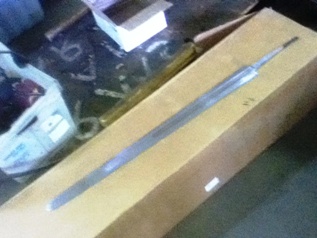

It will probably be some time before we see the final product, but Craig has just sent me an early pic of the pre-heat treated blade (see below). I’ll update this as things move along. Enjoy!

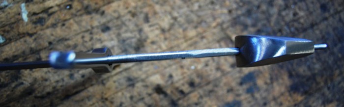

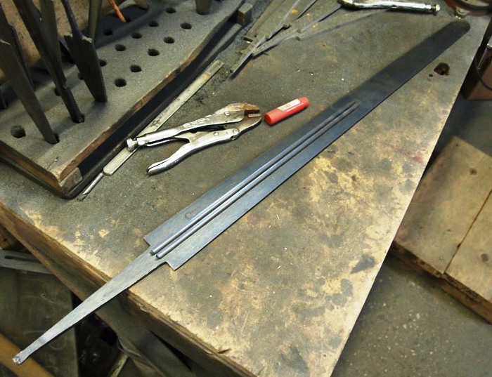

Hello Everyone,
I got these progress shots from Craig today. The blade is looking great - even fullers and quite flat as I requested. It reminds me of some of Michael Pikula's work with XIII blades. The pommel is developing some complex geometry. I don't recall seeing anything quite like this in modern reproductions. Very happy with how things are coming along.

PostPosted: Sat 20 Apr, 2013 7:58 pm    Post subject:         Reply with quote
Looks pretty darn nice! Can't wait to see it done!

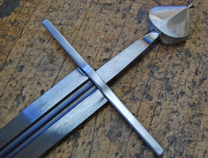

PostPosted: Sat 20 Apr, 2013 11:26 pm    Post subject:         Reply with quote
Really attractive design, and yes, it does remind me a bit of some type XIII or XIIIB swords made by Michael Pikula.
I see some bluing at the tang and at the blade shoulders probably to hot peen one or both and also tempering for lower hardness at these two stress point on the tang and making the blade tougher and less hard and ," a good thing " as far structural integrity of the sword. ( Not too surprised here that A&A and Craig know what they are doing here when it comes to selective hardening of blades: My English semi-custom Bill has a lot of selective hardening for edge versus body of the Bill. There is or was, even a video on the A&A site that showed the glowing heated Bill head being quenched ).
Anyway, this looks like a great sword in both senses of the word and it's always interesting to see in progress pics as well as the design and development history by the " patron " commissioning a custom sword and the interaction with the maker.
Craig/A&A is also one of the very good people/makers to work with for a custom project or to customized one of their regular in stock product to semi-customize them: Iv'e always had a good experience working with Craig. Big Grin Cool

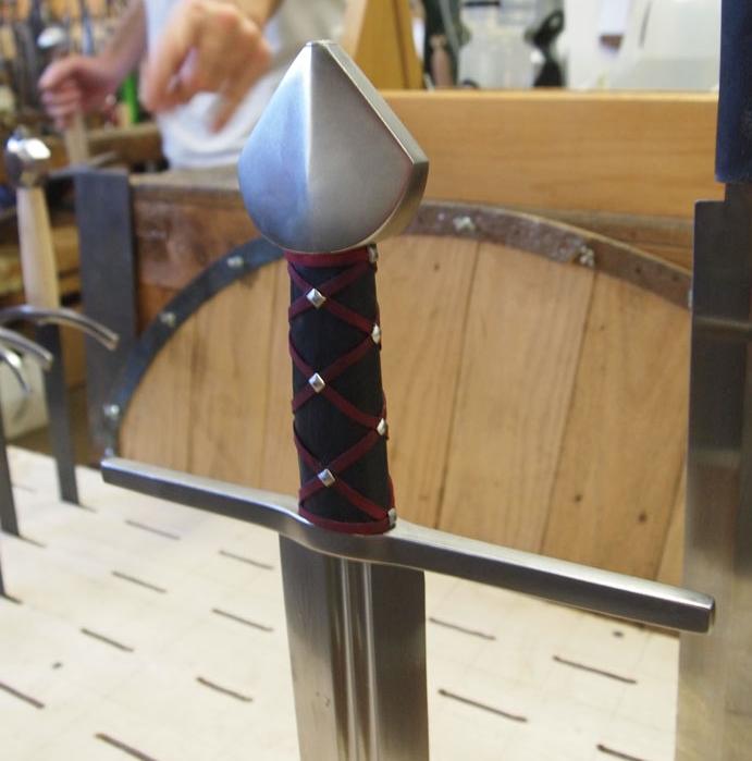

It's taken a while to sort out the grip on this one, but we settled on an over-wrap / pinned pattern from some period swords and art, with some ideas thrown in from from A&A's recent custom French sword (I liked the pins). I like to keep things simple so the underlying grip is basic black. What do you think of the result?

PostPosted: Fri 19 Jul, 2013 8:52 am    Post subject:         Reply with quote
Oh yeah, that's the stuff JD! Great one! I love this sword...
Roger Hooper
Location: Northern California
Posts: 4,393
PostPosted: Fri 19 Jul, 2013 10:30 am    Post subject:         Reply with quote
The grip looks good. It dresses up a spare design a little bit without getting too fancy.
It finally looks ready to ship.
