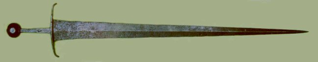

While we're at it, here's another one shown at Vikingsword. This one has been discussed here before, but its one of my favorites of this type. Its rather large for an XV - the blade is 84cm/33". Its dated to 15th or even 16th century based on the inlay, but it has an older look to me, despite the slightly hollow ground blade. Its like a big brother to Records XV.1
http://www.vikingsword.com/vmuseum/vmxv14.html
 Attachment: 8.08 KB

Probably I'm beating a dead horse here so will close this topic off unless someone else has something to add. It really seems like we don't know much about those early (13th century, early 14th century) XVs, even though we know they existed from Art.
On that note, I have a theory. Other than lengthening handles (XVa) and tending to go more hollow-ground, XVs changed very little in their 200 years of use. The early ones must have been 'ahead of their time', i.e., before armor went to full plate. Perhaps as they grew in popularity in the 14th/15th centuries many of the old blades were kept and re-hilted to make them more fashionable, leaving us with a lack of clear early surviving examples.
An example could be XV.3 in Oakeshott's records, another one of my favorites. With its long 35" blade and short handle, it has an old (13th century) look to it. But the style of the pommel places it with early 15th century English styles. Could this be an old 13th century blade that was re-hilted? The blade has one very interesting feature: profile like an XV, but lenticular cross section with no fuller. Lentucular blades without fullers have appeared occasionally throughout history, so one can conclude nothing from this, but this does seem like a natural 'missing link' between fullered lenticular blades (XII, XIV) and the classic flattened diamond XVs. (All speculation of course, as with so many things in amateur archeology).
I do have a personal motive: I like XVs (and recently bought a beautiful one from A&A in a 15th century style) but would really like to stick with the crusading era --roughly 12-13th centuries-- in my collection. Other than Albion's Poitiers sword (which is historically accurate for the type but a bit small for my taste) there don't seem to be any production XV swords that fit this era. It seems like there's no clear historical example for a commission so a bit of speculation will likely be required.

PostPosted: Mon 13 May, 2013 1:55 pm    Post subject:         Reply with quote
I am slowly growing to like and appreciate type XVs more, but I would like to point out that the swords pictured above with suspected profile changes due to honing doesn't seem to be a XV to me--the last bit of the tip seems too wide and too gradual a taper to conform with the straight-sided XV profile
"And they crossed swords."

PostPosted: Mon 13 May, 2013 3:14 pm    Post subject:         Reply with quote
Generally I prefer the fullered types, but there is something very pure and austere about the XV.
I agree that the point of the one pictured above (with the green background) is not acute enough to make a true XV. It does however appear to be an early medieval example of a fuller-less sword with a central ridge designed to give stiffness for thrusting.
