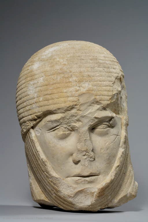

Posted: Sun 25 Aug, 2013 5:28 pm Post subject: |
Here's another odd example to consider: Louvre Inv. No. RF4217, Recumbent statue fragment from the tomb of Jean de Seygnelay, Lord of Beaumont (d. about 1296) Around 1300. From: church of St. Marien (Auxerre).
Although there is damage, it appears the decorated strap runs beneath the mail, rather than through the (now missing) rings of the brow. Attached is a slightly more frontal view, and it seems there is also a remnant of the strap on the left side of the face as well.
Attachment: 139.3 KB
