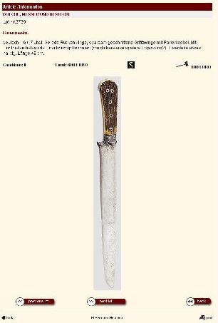

I have started a project that I had in mind already for some time - a bauerwehr from around the turn of 16th/17th century. I plan to use it in re-enactment, so it will be blunt weapon, not very much decorated.
I took my inspiration from the original auctioned some time back at HH, but I decided to go for a wider blade. Originally I planned to use bronze or brass on the hilt, but I did not find any historic evidence for that (it had been discussed elsewhere on this forum), so I went for a mild steel. The original piece has its handle made of antler, but the description says it might be a later replacement. I will use some hard-wood - an elm or plum.
1st picture: the original.

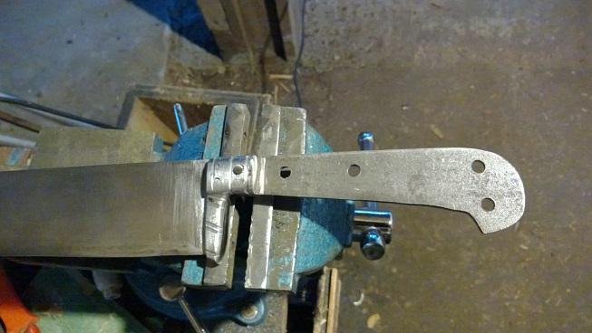

2nd: blade cut from the spring steel (N 14260) and roughly shaped by angle grinder (together with another one, for a different later project), with holes drilled for riveting the hilt components and the nagel. Later I have re-profiled the blade a little, making it more narrow to the point, but did not take picture of that.

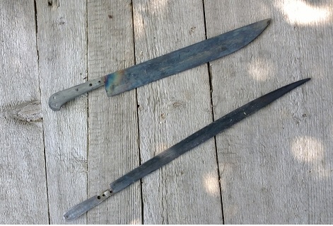

3rd: blades were hardened and quenched.

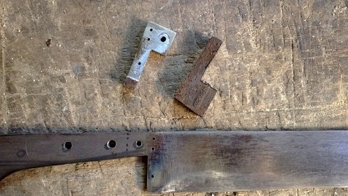

4th: I started making steel components for the hilt. it will be made from two halves riveted ant three points, plus secured by the nagel. Here you can see the first half with a recess already made, to accommodate the blade. another half is only cut from a piece of steel. Both were then shaped to match each other, and the blade, and riveted.

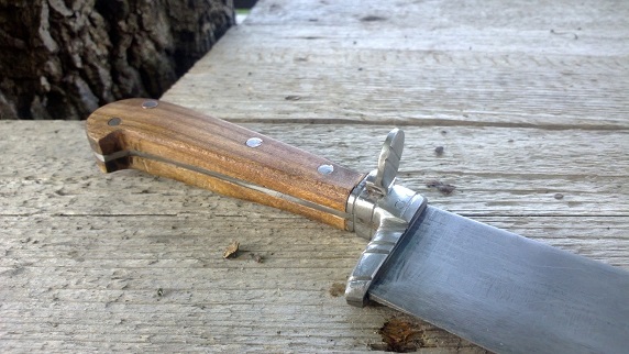

5th: they were riveted to the blade. then I have shaped them with grinder and hand files to the final shape (I can still do some re-shaping at the end, when I assemble the whole hilt), and cleaned by a sand-paper.

PostPosted: Fri 14 Jun, 2013 12:49 pm    Post subject:         Reply with quote
Looking forward to see this project progress: DIY projects with progress pics is always a learning experience for the person making them and for us to see how the different parts of a project where approached from choosing materials or making due with found materials and improvising.
Even with found materials the results can be very good.
Using an angle grinder freehand is challenging to try to keep bevels clean and sharp.
Using hand tools like files can be a lot slower but it has the advantage of control as it's way too easy to make a bad pass with a hand held grinder and take off too much material at the wrong place.

Now, I have managed to spend some few more hours on the project this weekend. First, I have shaped the "nagel". It was made from a thick piece of mild-steel, using the angle grinder and files. Unfortunately, I did not take pictures of the finished piece, so I´m attaching only this very simple scheme (pic 1).
The next thing I did was putting everything together: riveting front pieces to the blade, and cold-pinning the nagel (pic2).
Next I have cut scales from a block of elm-wood and drilled holes for rivets. I have tried different ways before to ensure that the rivet-holes on tang and scales fit, but the best method seems to be:
- I have holes for rivets drilled into the tang at the beginning (usually I do it before hardening & quenching)
- I secure (glue) on of the scales on the tang, and drill holes through it - it is important to leave the scale unfinished, because you are drilling from inside-out, so you can fissure the outer part. I usually leave few millimeters of material that will be sanded out then.
- I secure (glue) the other half, and drill holes through it. Here it is important to have a firm hand, because you will be drilling from an already secured scale, and you don't want to damage it.
- then you clean-shape both scales (already attached to the blade), pin rivets, apply decoration, etc.
Well, I have managed to get up to the last step, so the last picture shown the knife with scales attached, waiting for final shaping and cleaning, then rivets, etc.

"blades were hardened and quenched" So the blade is hardened. Are you planning to temper it at some point?
What do you use to cut through a thick plate of steel such as this? Angle grinder and cutting disk?

Re. tempering: in fact, I should have written: it was hardened and quenched, and tempered. Sorry for this confusing omitance. In fact, I do try to temper all the blades that I´ve done, but I have to stress that it´s just very amateurish, learning by doing exercise. Here, I was trying to apply what I have learned on smaller blades (knifes) and the result is of course not perfect.
For cutting, yes I use angle grinder and a cutting disk, and then the lamellar disc for inner arcs. For this I had used 500*50*5 mm piece of spring steel, and it "cost" me nearly one cutting disc - which is not that awful, given the amount of material that needed to be cut-off. If you work slowly and don´t push much, the disc does not get worn-off so fast.

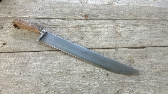

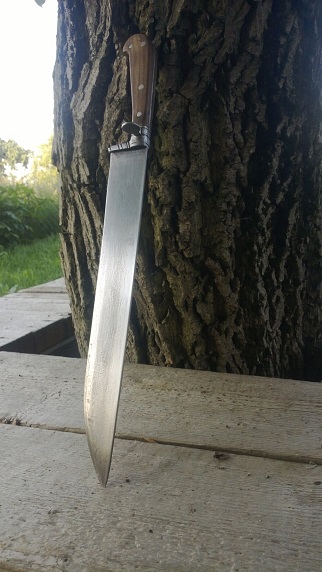

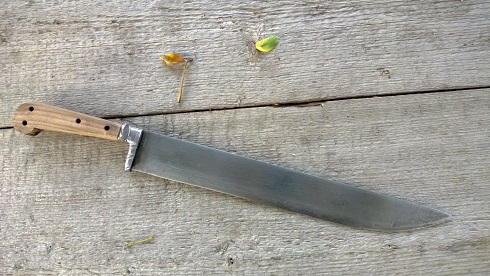

and, after final cleaning with sand paper, here are couple of pictures of the finished piece. comments and ideas are welcome.
also, let me repeat the previous question: would be a by-knife out of place with this kind of bauerwehr? thanks in advance.

Hugely impressed with your work here. Project started on the 13th and wrapped up on the 20th? Bravo!
Eric W. Norenberg
Joined: 18 Jul 2008
Posts: 271
PostPosted: Thu 20 Jun, 2013 10:39 am    Post subject:         Reply with quote
Radovan, that knife is excellent! Your skills as a "hobbyist" are astounding, and you are building quite the body of work! This is one of the original bauernwehren that I have saved photos of to my Iphone, that I hope to replicate myself someday - you are setting a high mark to aim for!
I don't see any reason not to build your sheath with a by-knife, and possibly a pricker. I can't recall when the prickers kind of fall out of use but I'm pretty confident a by-knife would be appropriate. Make it as well as you did this big knife here and nobody will criticise it even if it isn't 100% period correct anyhow!
Cheers!
Eric

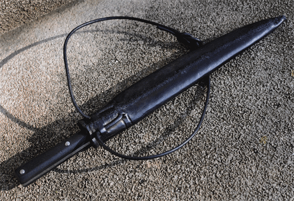

I'd vote for a double-layer scabbard with integral sheaths for byknives. If you don't want to immediately start the byknife project you could model those in balsa and use them as forms for the scabbard.
For suspension, you could do something like this, with slots cut in the back to create a channel for a thong. More shots of that scabbard are here: http://www.myArmoury.com/talk/viewtopic.php?t...ght=eating
 Attachment: 219.33 KB

If you decide to make a wooden scabbard, note that the typical German sword knot worked perfectly for the wood core scabbard of this toy short sword. That by-knife is poplar.
This piece was inspired by the short swords shown in the hand of the apostle Peter in German/Austrian depictions of the arrest of Jesus. Those are sometimes messers, sometimes short swords. So, I think this suspension is within historical spec for a short German weapon of the late 15th/early 16th c., although I don't recall seeing a messer suspension done this way.
Messers the size of yours appear to have the narrow belt passing through a channel cut in the back of the scabbard, which suggests to me that those scabbards are two-layers of leather.
 Attachment: 22.95 KB

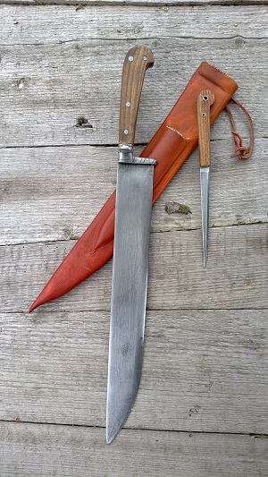

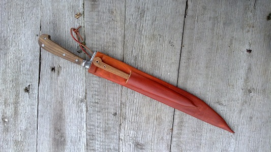

After a long time, I managed to finish the scabbard and the by-knife.
Scabbard is constructed from two layers of leather and hand-stitched with sinew. first layer of leather was hardened in hot water.
For by-knife, I´ve just used a blade that I had at hand. The handle is from elm-wood with hollow rivets from rolled copper plate, to replicate the design of the bauerwehr. Originally, the scabbard was made for a wider blade, but I´ve ruined that one. When I have a little time I might make a new by-knife, but for now this is it.
 Attachment: 100.49 KB
