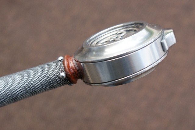

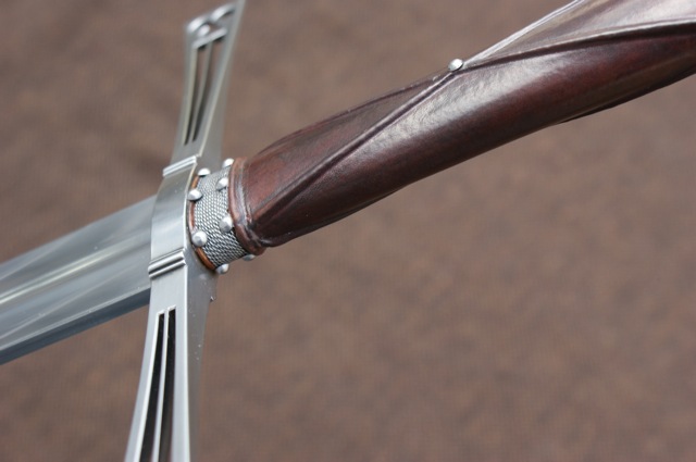

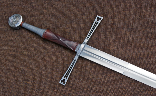

Hi guys!
About the wire grips: they are done with a specially thin iron wire that is twisted in shop to proper tightness. For shorter wraps this pose little challenge. For longer grips it sometimes gets interesting as you have to keep the two wires to be twisted properly stretched during the twisting. I know Eric will have to go diagonally across the room to get the longest sections done.
The wire is then wrapped *over* the leather that covers the complete grip. This is according to how I have seen it done on originals with this kind of grip surviving. The ends are fastened and held down with small domes tacks that are driven into the hard wood of the grip core. They will not loosen or let go of the wire any time soon.
The leather also helps in increasing the grip for the wire.
I use exactly the same method when I make wire wrapped grips for late gothic swords. As has been remarked, it is a style that is appropriate for certain types of swords and belongs most securely to the 15th century. There may be earlier examples, but I think the evidence for that is mostly in depictions in art. I cannot now remember seeing a single surviving original with this kind of partial wire wrap earlier than the 15th century.
Full wire wraps are of course in use for both earlier and later types of swords. We have not yet developed a good durable solution for this kind of grip yet. I find it an interesting option and would like to use it on some swords. We will see if we can offer a full wire wrap on some swords in the future.
Thanks for showing interest in this particular type of grip treatment. I personally like it very much.
I did use it on a long sword i made earlier this year.

I saw that sword today, amazing work and the wiregrip was nothing short of fantastic. If one likes the look of wiregrips, I can highly recommend them.

Thanks for the info guys. That's a beautiful sword btw, Peter. After seeing pictures I do like the look but I'm just wondering why someone would only wrap half the grip. If the original swordsmiths had a method to make durable full wraps it doesn't seem like it would be that much more expensive in either time or materials compared to a half wrap.
