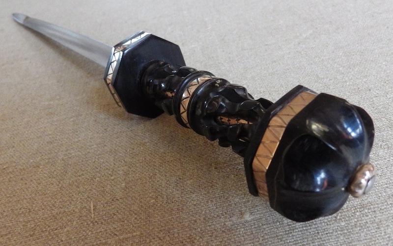

Hi All
This was made for a client who wanted a posh 15thC Burgundian style rondel and this fitted the description well.

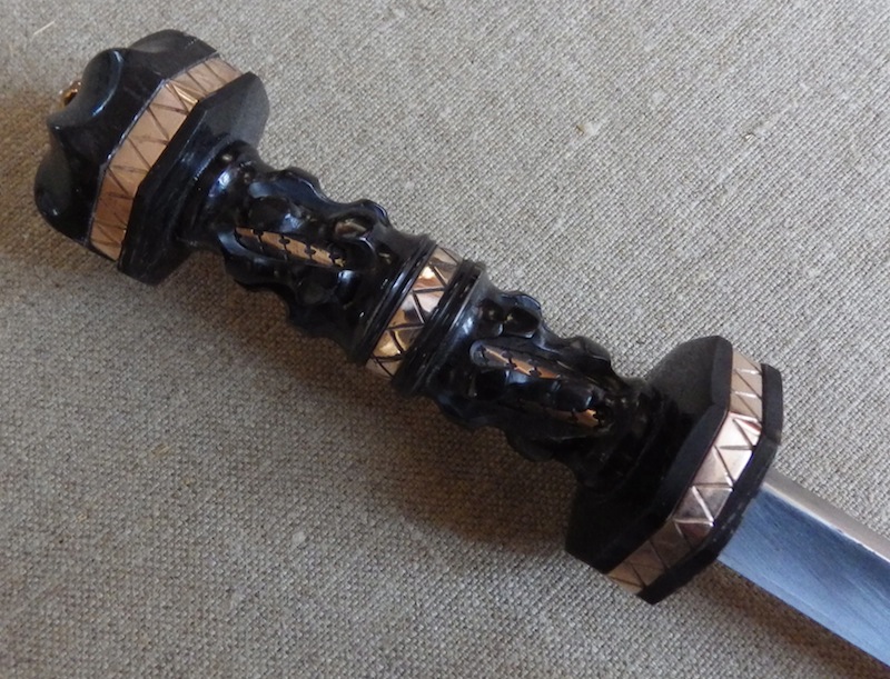

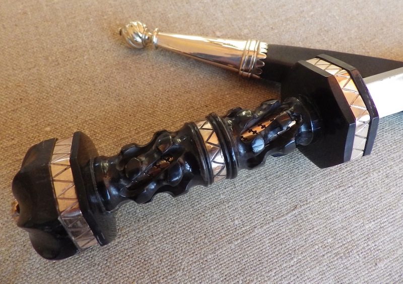

The original is most likely late 15th or possibly early 16th and again is possibly Italian. It follows the usual pattern of Burgundian style rondels in that the top disc is quite bulbous and the lower rondel is also thick but generally flat. The hilts on these daggers were always showy and often utilised horn in their construction as this does. In this case the rondels and the grip are adorned with bronze panels.
What makes this dagger unusual is that the horn handle has vents cut through to the core inside which is made from an engraved bronze tube.

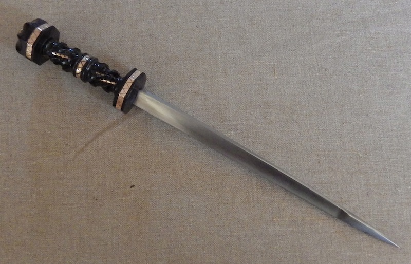

The blade is single edged with a severe hollow grind and a reinforced point making for a light but very stout blade. Also unusally for Burgundian rondels the blade is long at around 13".

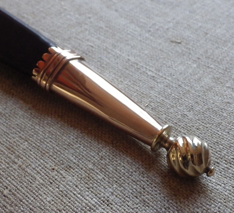

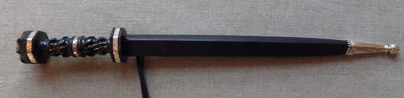

The scabbard is wood cored, leather covered and has a bronze chape.
I have wanted to make this dagger for a long time and I am pleased with the result - I hope you like it too.

Thanks Fabrice.
The book it came from lists it as 'Italian?' I am not sure why they said this as it looks as Burgundian as can be, but I guess everything was made for the export market so maybe it is an export piece. Burgundian daggers usually had shorter and stouter blades and so maybe this is part of the clue that perhaps it is a little out of the ordinary. Either way it is a lovely dagger and one that had to live again.

Although this dagger was snown some time ago, it's a REALLY stunning piece.
As I've never seen such, I just would like to ask, if we have period weapons with such grip - outer organic handle (doesn't matter horn or wood, or bone) and inner metal tube?

Yes Boris we have; this is a copy of an original that Tod found in a museum catalogue (I think it's in the Museo Nazionale del Bargello), I was simply fortunate to have asked for something that gave him the opportunity to bring it back to life. Also, Fabrice Cognot has posted a lovely bollock dagger he made here: http://www.myArmoury.com/talk/viewtopic.php?p...ht=#237396 - the original has a metal core.
