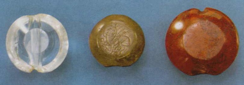

Here is plate 23 that they mentioned from Dufty's book "European Swords & Daggers in the Tower of London"
(since I recently acquired it :-) Mac

Rock crystal pommels are rare but not unheard of. Here is Pavel Moc's reproduction of the sword of Saint Václav:
There seems to be a sword or two preserved in Germany, as late 19th - early 20th century repro maker Ernst Schmidt featured a couple in his 1910 (?) catalogue.

PostPosted: Fri 14 Jan, 2005 6:59 pm    Post subject:         Reply with quote
anyone have an idea of the masses of the pommels discussed here? i guess where i'm going is that sure, many of these swords are decorative and perhaps ceremonial/bearing swords, but do they have the handling characteristics to hang with their more common, metal-pommeled brethren?
and did i read those dimensions right? if so, this sword isn't too much longer than a healthy dagger; very courtly/cosmopolitan

PostPosted: Fri 14 Jan, 2005 7:15 pm    Post subject:         Reply with quote
absolutely lovely sword, Mac! and thanks for the link to the old thread, Nathan Happy
The three pommels that Mac posted have no listed masses or dimensions, at lest in the book from which he took the pictures, "european swords and daggers in the tower of London".
I know that is not helpful Laughing Out Loud But I thought I'd post it anyway.
