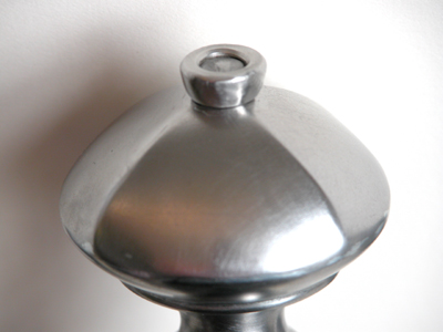

PostPosted: Thu 03 Mar, 2005 12:18 pm    Post subject:         Reply with quote
You might be able to remove the nut with a pair of locking pliers. They'd bite deep into the nut, but might provide enough leverage to unscrew the nut over the peening, pushing the metal up as it goes. Even if that destroys the nut, it's a standard thread size, and would cost you only pennies to replace. I had to replace the pommel nut of an MRL rapier, and that project worked out just fine. details of the new nut are here:
http://www.myArmoury.com/talk/viewtopic.php?p=34845#34845
You could also use a wing nut as I did, but right-side up to form a conical nut profile that might be more attractive than the original cylindrical nut.

Sean! You da man! Laughing Out Loud Thank you for your fantastic response. You even answered a question I hadn't thought to ask, regarding Windlass tang threads being a standard size. That's good to know. The ground and polished wing nut is a great idea. Great suggestion too about getting the factory nut off. I think I'll give that a try.
Thanks,
Scott Happy
PostPosted: Thu 03 Mar, 2005 1:02 pm    Post subject:         Reply with quote
By the way, save the final polishing of the new nut for AFTER you re-assemble the piece as you're likely to gouge it during tightening. You can use a piece of thin cardboard to shield the top of the pommel as you file/sand/polish away flaws in the nut.
