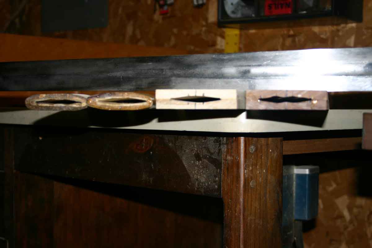

One important point does not seem to be comming up in this forum. Anyone starting a DIY scabbard project needs to recognize that not all swords have a full length fuller or a full length diamond profile. All photos of example cores that I have seen in the forum are really only good ideas if the basic blade profile (diamond or fullered) is the same for most of the length of the blade.
I have been making different types of scabbard cores and experimenting. In this case the sword is an Albion Crecey Grete, which you may be able to see from the photo is actually my well used practice sword (blunted) at this point. It has a fuller that only runs about 1/3 the length of the blade. The beginning of the diamond profile ridge is just about as thick as the ridges of the fuller near the guard. This means that depending on insertion of the sword into the scabbard at a sloppy angle, I may need full clearance anywhere within a 3/4" wide slot at the center of the scabbard mouth. A nice fuller type mouth is feasible if it is cosmetic and very loose, but blade insertion/withdrawl can jam up very easily.
Four example cores in the photo. The first two on the left are cloth lined, and the cloth yields as needed when the thick spine of the diamond profile passes through. You can tip these scabbards close to vertical and the sword does not fall out. The one second from the left is fiberglass / epoxy laminated and a 200 lb man can stand on the center of it while only the tips are supported. The 3rd sword from the left (unshaped poplar) has a canoe shaped mouth. You can drop the sword in from any angle and it will center itself true. Unsheathing is similarly non-fussy. The far right scabbard is walnut and simulates the fancy fuller geometry that several have posted. This is actually very loosely fitted near the fuller, however the curvature causes the diamond cross section spine to hang up unless insertion/withdrawl is done very carefully. I advocate the canoe shape scabbard mouth for any sword with a fuller than only runs half the blade length or less.

Jared,
I think the issue is one of cross-section rather than fuller length. On a blade like your Crecy the blade starts out with a diamond cross-section and then has a fuller machined into it. Consequently, the blade's cross-section will be thicker at it's center near the point end. This will cause the drag you're experiencing during insertion. On a blade with a lenticular cross-section this isn't the case, so the length of the fuller won't matter.
I'm not saying you're wrong, but trying to illustrate that there are as many ways of doing these things as there are types of swords.
You do have a good point, Jared... the scabbard should be appropriate for the sword. In the case of the Knight, this works quite well. Others would potentially need a different design.
