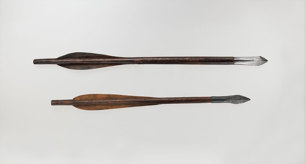

Dan Howard wrote: | How many heads have been found with the shaft intact? If only the head remains, how can anyone tell whether it came from an arrow or a crossbow bolt?
Thickness of the shaft would give a clue, I think. Anyone have some data?
There are quite a few complete bolts in museums. For example, these from the Met Museum, dated 15th-17th century
The top one seems a good match for Tod's "plate cutter", though I'm unsure where that identification comes from/ is based upon.
