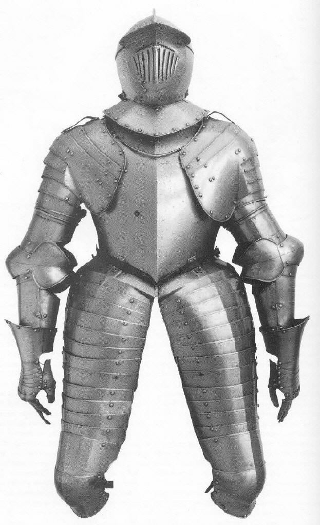

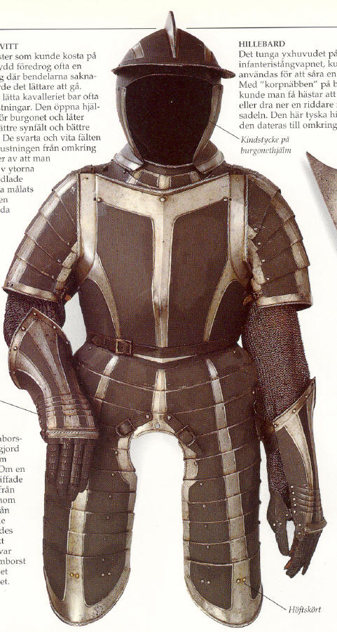

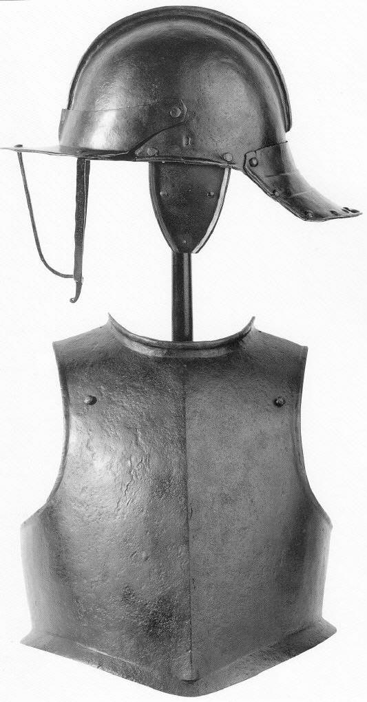

Some pictures of various armours which probably are "munitions armour", I've tried to select pictures of armorus which to me shows the wide range of quality coverbed by the term "munitions armour".
Almain rivet armour from the City of Winchester museum
Harquebusier "pot" and "breast"
German Cuirassier armour from about 1620-1630
 Attachment: 117.95 KB, Downloaded: 830 times
Reiter or landsknecht armour from the 1550's [ Download ]
 Attachment: 84.62 KB, Downloaded: 677 times
 Attachment: 98.34 KB, Downloaded: 679 times

So back to munitions grade armour- Graz,
I was looking at the images here and some on the internet, and I have to ask how do you get the finish like that on the Graz armours ? I have seen other munitions armour but it has a polished finish (as per the preceding thread).
