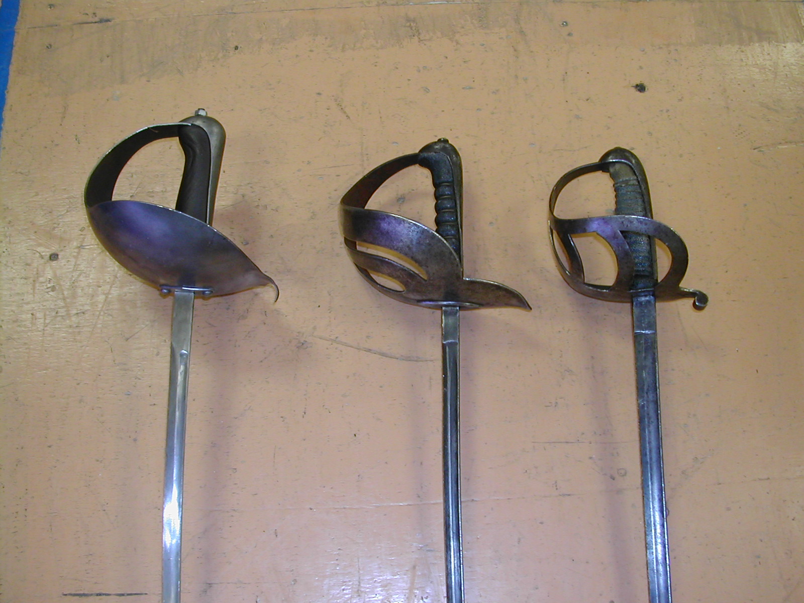

I have some somewhere. I thought I had them online, but I only have one: http://www.slithytove.org/pics/3_sabers/
I have some other pics online comparing the Darkwood guard to some historical Italian and English fencing sabres at http://www.slithytove.org/pics/3_sabers/
I'll try to get the others to you soon.

That dosen't look too bad really. Have you taken it apart? What is the tang like?

We didn't take it apart, but based on Scott's other work I feel comfortable assuming the tang is quite appropriate..

From the standpoint of a living tradition dueling sabre practitioner, it really does not look that good. The shape of the backstrap is just *not* right - and the grip is rather oversized for the type of sabre meant to be reproduced.
The backstrap in http://www.slithytove.org/pics/3_sabers/DSCN1507.JPG is providing a swelling toward the hilt, curving with the blade. This provides, functionally, a negative cant to the grip. While this is fine for many French sabres (like a Cheval d' Chasseur sabre from the Napoleonic era), it's not at all appropriate for an Italian dueling sabre. These sabre tend to be either neutral, or slightly positively canted. The center sabre is the best example of an Italian dueling sabre compatible backstrap, although the one on the right is acceptable as well (I personally prefer the one on the right - but it seems to be slightly less common). The grip shape on this Darkwood example is definitely an improvement on the one on their webpage.
Reference to original tangs:
The tangs on the original blades are generally a very narrow wedge shape - far smaller than one might expect. This helps provide a forward balance point - at least more so than a modern fencing sabre. Indeed, while the antique tangs start a bit taller and narrower than a modern fencing sabre tang, they taper dramatially in a wedge shape, with probably 2/3 of the total mass of a modern fencing blade tang. This is important because the steel guard and steel backstrap add quite a bit of weight over the modern sabre guard.
I can't speak to what the Darkwood tangs look like not having seen it. I'm very curious about it though.
How long was the blade? anything over about 34.5" is probably a bit much... It looks like the Darkwood website lists it as a 36".
I do like the Darkwood Radaelli guard shape - they got the ridge down the center correct - rather than the reversed version on the Hanwei model (The Radaelli text is clear that it is a ridge, not a depression) and indeed, an old beat up, branchless Radaelli that my club had some years ago was also a ridge. However, I don't care for their Pecoraro guard.
Negrini also sells Radaelli and Pecoraro guards - and I like the looks of those, but they're pricy, and don't have a backstrap availible.
Edit for clarity: The Darkwood blade I simply cannot comment on beyond saying it looks a bit long - as for the quality, if its as nice as the couple Darkwood rapiers I've handled, it'd be nice indeed. I think they've got a good solid concept going, but it needs some refinement to really hit the nail on the head. I don't want to be overly hard or critical, but there is a pretty small range of variation that can be allowed before the subjective handling and function starts to change.
