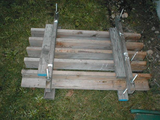

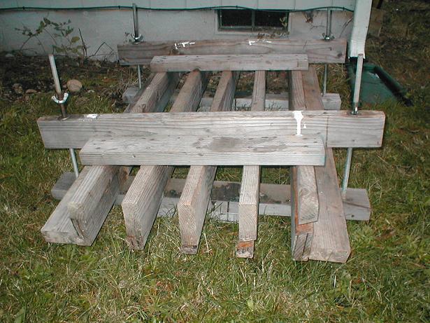

Here's the shield press my group uses. Its a got to be fifteen years old, but it keeps crankin' em out. My large war shield is included so you can see the curve. They're not that hard to make, but once people see the results, you'll be making shields for everyone you ever met. Eek!
A few notes on curving shields, let my sweat and expense save your sweat and expense.
Not all half inch plywood is half inch thick. thinner is better, unless the wood is cheap. spend the extra money for better quality wood.
The grain of the wood MUST RUN LENGTHWISE. Make sure when you CUT the wood that you take this into consideration. I have two or three broken sheets of plywood rotting in my back yard. They could have been contenders.
use a brush and wood glue to get a good even coat between your two sheets. if you just pour glue like it was honey on toast, you'll have gaps where mildew and rot will set in.
Once the glue dries, it is what it is. Dont try to curve an already set piece.
As you tighten your press, keep an eye on the edges of the two sheets as they will shift out of alignment.
Do not pick you nose with glue on your finger. Get a tissue.
Hope that helps.

Use Elmers wood glue. Should take a day and a half, two days tops. 18hrs if you live in a hot dry climate.

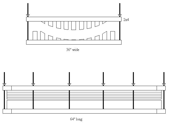

Something maybe like this?
btw, I'm just guesstimating numbers here.

Classic case of a picture worth a thousand words. Very helpful to those of us, like me (maybe only me?), having some difficulty visualizing the specifics of the process. Now, all is clear.

Nice drawing. Big Grin threaded rod at the corners does it, you dont need that many, but i see you've grasped the concept rather nicely. the angled sections are 2x6 studs cut at progressive angles. The rod is 1/2 inch. Five 2x6s works just fine, three doesn't give a good dish, it just bends in the center. You can charge your friends five bucks a pop till you cover the upfront cost. If you're really a mercenary, or if you're playing landsknechty type, you can charge more. Wink

That'd work, yeah. Just set your curve. That's a good bit fancier than mine is, but eliminates the issue of the straps.
Mine's more like the top piece of yours, though the concept is turned 90 degrees, with each rib having the full curve and the suports just keeping the spacing right, and you use the straps to draw the "ply and glue sandwich" to the curve. Never did make it out to the shop - metals work tomorrow, it was a textiles and leather day. I'll try again tomorrow for pics of the thing, possibly ones of how I set the curve, too.

Oh by the by, those flat 2x4s on top of the press are there so you can stand on top, to assist the press. This is one of those times when it helps to be a fat basilard Laughing Out Loud
