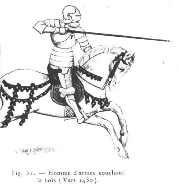

Here's a French image dated 1430 - see Claude Blair, 'European Armour', p. 201, for a closeup. The nose peeking out is a frequent feature in the art.

I'm at work at the moment so I don't have any references handy, but I'm pretty sure that the oldest surviving sallets date to 1430ies. I'm pretty sure that there is a sallet in an English church that dates to about 1440. I don't know about bevors though.
I think with celatas we are on thinner ice. Judging by its appearence the celata seems to have evolved from the bascinet, but when does it stop being a bascinet and become a celata? I think what complicates this further is that the 2 were probably used side by side for a few decades. AFAIK bascinets were still being used in the 1440ies when both sallets and celatas were definitely around.

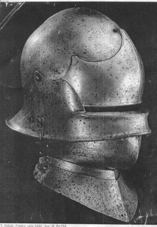

That 'Burgundian' salade in the RA would indeed look very similar with a bevor, but here's one in Paris that is dated to c. 1430.
Hi James!
How do we know this dating is accurate? The reason I ask is that I've really come to be leary of dates assigned to artifacts/manuscripts/etc. from researching swordsmanship treatises.

Something to keep in mind - the tail of the 1430 salade is round like a 'barbute', not pointed as in the German style. This seems to be characteristic of French salades. The 'burgundian' has a tail that narrows, but doesn't come to a point, either.

Christian, I had quite a set-to with Jean-Pierre Reverseau, the curator of armour at the Army Museum in Paris when I was there about the helmet in question, and he wasn't budging. My own belief is that it could be later (the crest influences me in that direction), but the pictorial evidence is abundant, and the later salades don't look noticeably different than the earlier.

P.S. The associated bevor is another matter, and it looks later to me. We didn't discuss it, however.

Yes, I can buy that James. The bevor is what was bugging me the most.
