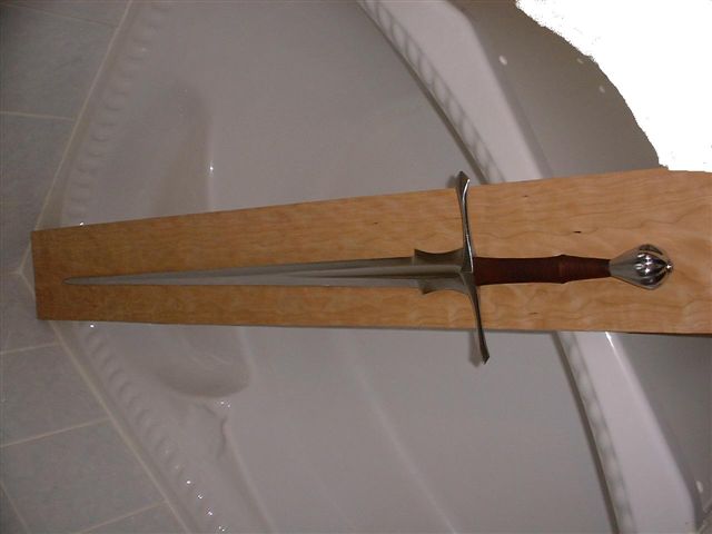

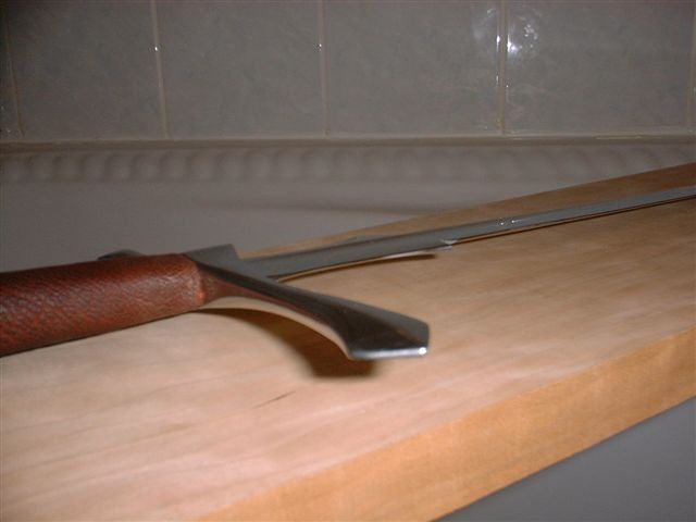

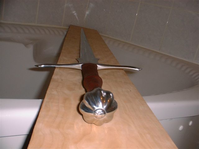

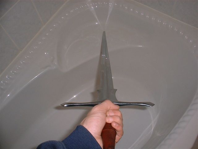

Hi All,
Picked up my new sword from Mark Vickers of St George Armoury last month,
based off a sketch and description in Ewart Oakeshotts The Sword in The Age of Chivalry,page 79,ref fig45,
Basic stats,
overall length, 45 1/2"
Blade length, 35 1/2"
Blade width at riccasso,lugs and at crossguard 2 1/2"
riccasso, 3"
Blade width at 1 1/2" from point 1/2"
Blade thickness slightly thicker last 4-6" of point
Fuller length 11 1/2"
Point of Balance 2-3" from point of eccusson,hard to gauge on riccasso, Eek!
centre of percussion 12" from point
Guard width 9 3/4" guard ,Type 10 ?
sliight centre rib to guard either side of ecusson flared ends,
Handle length 6 3/4" not inc pommell,
Cord over wood,leather covered,raised mid centre,

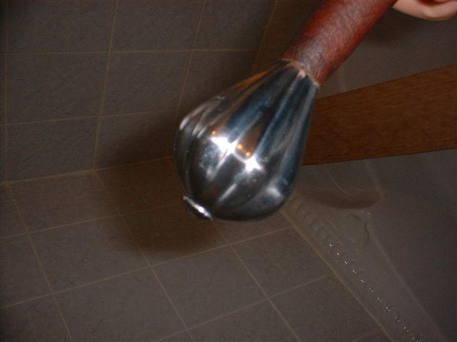

pommell length,2 1/2" peened with peen coller, modified, T.5
Weight 3 pounds 2 ounces,
Price point £320.00
www.stgeorgearmoury.co.uk

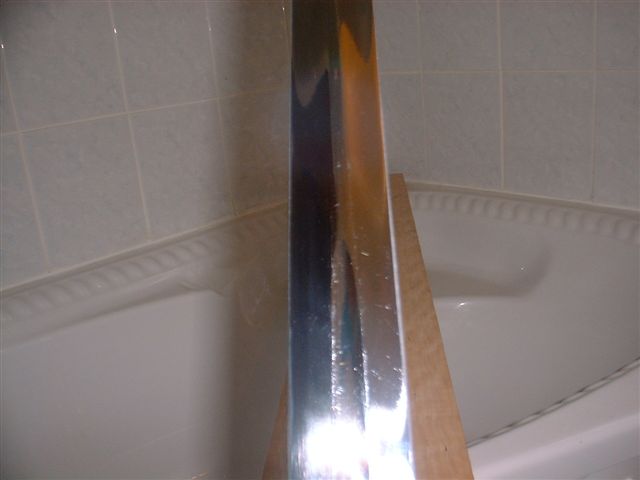

There is alot of detail in the blade not obviousley apparent from my pics,

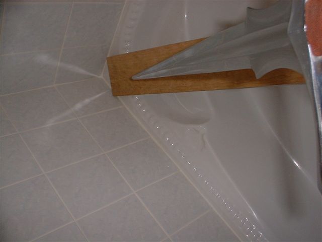

the riccasso is slightly hollow ground either side, notably thicker at the lugs and crossguard,
after the riccasso the blade goes into flat diamond feathered into hollow ground from around the last inch of the fuller to the last 4-6" before the point,the last area of the point flares slightly thicker for thrusting,
i cant give you exact thicknesses as my calipers still seem to be awol Sad ,but the differences can be seen by eye,
Handles amazingly, as a single hander,tracks easily,stops almost with only the thought,two handded use is awsome,havent cut with it yet but it's a sharpie and from dry handling alone i think cuttings going to be a fun day,
Fit and finish is very nicely done,
handle leather is pretty easy on the hand,pommel is nicely finished,very tidy peening with a little detailing to the peen coller,very tight fit to the hilt assembly,beautifull ring to the blade when tapped,
After having this sword a few weeks the most notable impression i'm left with is whether i need another hand and a half,
if this was the last sword i could buy i wouldnt mind shocking as that is to say,from the collecter perspective,it wont be though Laughing Out Loud
Thanks for looking and i hope it all made sense,
I would also add a note of thanks to Nathan Robinson and Peter Johnson for some fantastic help behind the scenes via pm and email,
Two fine gentlemen in the sword community,
Now onto to usuall Eek! pics,

Great lookin' sword! Congrats! I like the way the ricasso is slightly waisted. It certainly gives the sword more character.

Beautiful sword Cool . Very interesting choice of example to commission. There are a few makers with training swords of similar design, but it adds a whole different dimension to the design seeing it made as a sharp. Also looks to be quite a value for the price. Congratulations!

Congratulations, Lee. Your new sword has a great style to it, the blade in particular. It seems from the pictures that the sword is well made. And it looks like a very quick one, too!
