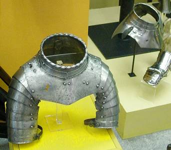

I cant find any information about central rope - how it riveted to gorget?
See picture for explanation.
Small foto taken from the GrimmArmory.com - which now have other galleries.

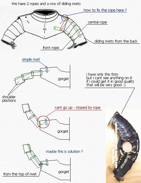

No. Ropes are 100% at the bottom, and i will explain why.
See explanation picture.
Thats why even such models as Maximilian Gorget appeared.(see picture gorget1.jpg)
+ it takes breastplate weigth on all shoulder area(unlike small gorgets - gorget_small.jpg)
who were in graz museum, can answer this question =)
 Attachment: 10.76 KB
 Attachment: 9.73 KB
 Attachment: 17.25 KB
 Attachment: 6.68 KB

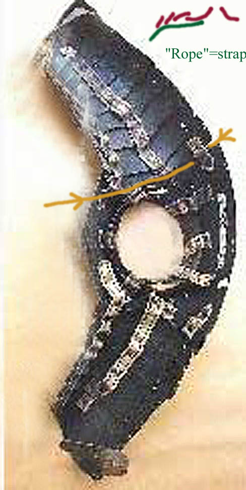

Yes Izya....This is true..............Its just that in the photo you posted the lames LOOK like they sit on top while the "ropes" (straps) would be in the usual position underneath.
 Attachment: 75.08 KB

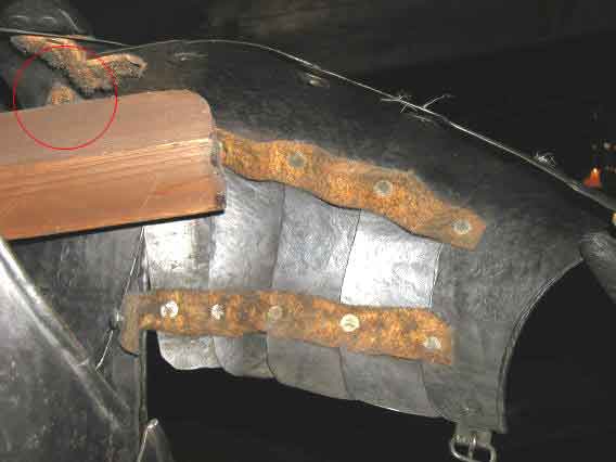

here is the picture that shows small segments.
 Attachment: 9.24 KB

are you sure it does attach in the center? would make since not too. the 2 on the sides are sufficient to hold it in place.
the rivets shown from the top show me that the ones near the neck line attach to the "ropes" as you call them on the lames on the neck. there is also a pin rivet that keeps the front and back closed.
if it does attach, the top lame does not move very much.
is teh upside down picture the same as this one? http://www.myArmoury.com/talk/download.php?id=8788 because in this picture it looks like the top lame articulates off of the rivets. i know in some lame articulations teh articulating rivet is used as dual purpose: to articulate and to hold the leathers or roping for other moveing areas.

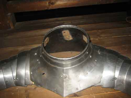

PostPosted: Fri 24 Feb, 2006 12:23 am    Post subject:         Reply with quote
David Lindberg: Can you post a picture ?
Here is some interesting pictures.
 Attachment: 17.83 KB
 Attachment: 14.34 KB
