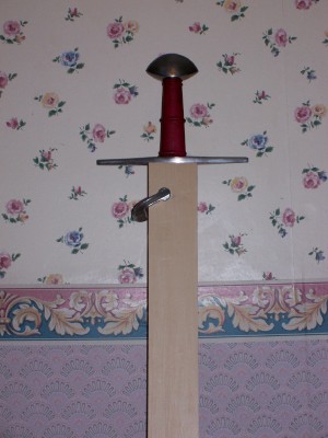

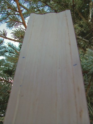

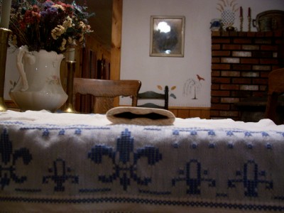

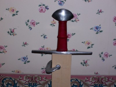

Here are a few pics of what I've gotten done so far...

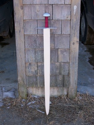

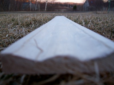

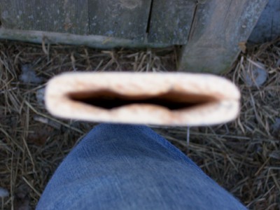

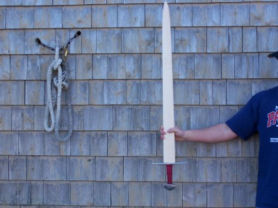

New pictures of the finished core. It may still be a bit thick. I didn't think so when I was making it, but upon seeing a picture of it, it looks bulkier than some of the cores I have seen here. Still, I'm very happy with how it came out, being my first try. The leather work though.....
The money shot. The fit seems to be about perfect. Comes out with a lil tug.
This is the pic that worries me. In person it doesn't look that thick or blocky.

I'm far from an expert, but it does look a bit bulky in that last shot. You've probably seen these before, but here are pics of the core of my Sovereign Scabbard (core by Aaron S.). The first shot is the bulkier of the two. The second has been worked down further.

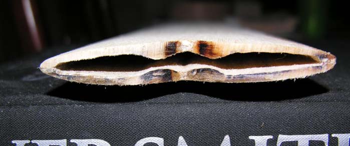

I had seen the first pic, I'm not sure about the second. That certainly is thin. What I did was trace the cross guard and thinned it to the same width as the cross. I got the idea looking through Aaron's photo album of his Knight scabbard. I might thin it out some more with sandpaper, but I don't think I'm going back to the desktop sander. Right now the walls are approx 3/16 of an inch. What do you think would be an appropriate thickness?

Hi Kenton,
I did the "draw around the crossguard" thing with my knight scabbard, and it came out Ok. I'll probably take the next one down maybe another 1.5mm thinner though. The slats ended up a touch over 3mm thick at the throat. There are pictures of the slats in this thread:

Well after a couple of hours, a few sheets of 150 grit sandpaper, and a minor case of carpal tunnel I've got my core down a little more. Again, it looked a lot better before I saw a picture of it. I think the thickness must be relative to what scale I see it on. Anyway, here is where it stands now...I may work it down more tommorow, I may leave it as it is. The walls are between 2/16 - 3/16 of an inch now (I'm too American for metric Laughing Out Loud )
Al, your scabbard is great by the way.

I'm no expert on this, I'm just coming from a position of still processing my learning experiences from building my first one and remembering all the things that went wrong. Hopefully if I'm completely wrong about what I'm about to say one of the many people on here who know far far more about this than I do can correct me, but here goes...
It looks to me a bit like part of the chunkyness you perceive when you see the photos of this is because your cross section is quite rectangular. If you made it more oval then you could get a much daintier looking cross section without having to thin the walls down over the center of the flats of the blade. The material in the corners of the cross section is almost redundant because your blade is so thin there.
I've just knocked this picture up to try and illustrate what I mean. The top one is a rounded, but still quite rectangular cross section, the one below it is just as thick at the center of the blade but is oval in cross section, with the result that it looks less chunky. The next one down is just the two shapes superimposed, and the bottom one is a very slightly thinner oval.
If using sandpaper and a sanding block is giving you carpal tunnel, but a belt sander is too quick, try finding rubber sanding wheels that mount in a drill. I've got one of these that I've used for other things and they're quite handy for shaping wood. It's just an 8" or so rubber wheel with an axle that goes in a drill and can take different grades of sanding disc on the face of the wheel. It's flexible so you can do curved things nicely and if you put it in a cordless drill it doesn't remove stock so fast that you risk going too far.

PostPosted: Sun 19 Mar, 2006 2:31 pm    Post subject: Reply with quote
I agree with Al.
There is no great way to do the tip. I wrap a stiff paper or very thin cardboard with overlap. After drawing a centerline on this pattern piece, I slice it down the centerline. Unless the patterning material is slightly elastic (like wet leather) it will still be imperfect. Excess leather is needed and has to be trimmed while sewing. Similar issues occur if there are areas where you have glued on risers, embossed shapes, downturned wool "socks" (from liners), etc. The only way I have found to really get a perfect centerline is to cover once, mark in ink on the leather where and how much adjustments need to be made....then start over with a new piece of covering. Alternatively, you can cut the covering extra wide and punch holes fairly far apart (at least 3/8") from the seam. If you trim the seam as you go, the stiching will not be evenly spaced in terms of width when you use this "trim as you go" approach. I have just settled on uneven width between the stiches since I hate to through away a piece of leather that I have probably paid something like $10 to $20 U.S.
Fiebing's analine (alcohol based, not the water based institutional stuff) die works vastly better than Tandy's. I have tried both. Also, the Fiebing's Carnuba wax finish (different from the balm with Atom wax) gives the most professional looking finish. You need to burnish the leather both as the dye is drying and after applying the balm/wax to give it a shiny closed grain look like a professionally made shoe. I actually dye part way, then burnish as the wet look goes away when the dye is soaked up. This is done by rapidly rubbing the surface with a piece of canvas (painters canvas drop cloth will work... I use an empty bag from a 20 pound lead shot bag for shotgun shell reloading.) A friend of mine sewed up about 1 square foot of canvass like an oven mit, and has used it for hundreds of knife scabbards. Burnishing is done by very rapidly rubbing the canvass back and forth. You need friction and some noticeable temperature increase (like rubbing hands togather quickly can heat up the skin.) If you can get a hair dryer gun type blower, you should be able to dry the alcohol out within 5 to 10 minutes between covering, dyeing, and proceed right to the carnuba wax finish within the same hour that you finished stitching. When you stop the dryer, if the leather cools to the touch quickly, it indicates that alcohol is still evaporating and you need to dry more. The wax finish needs to dry slowly so that oils are absorbed. Set the waxed scabbard aside (after burnishing the wax finish) and do not disturb it for about two days. It may show finger prints if you handle it too soon after the waxing. Otherwise, it should look as nice as any store bought leather good you will ever see. A buff with a shoe shine finishing buffing brush should be the last step.
If you live in the U.S., you can order the Fiebing's professional dyes and the Carnuba wax finish from Siegal of California.
The image I posted in a previous post on my Knight scabbard is really as satin shiny/ glossy and smooth looking as it appears. It is not just lighting. That is due to the burnishing steps which close up the grain of the leather.
http://www.myArmoury.com/talk/viewtopic.php?t=6096&highlight=
