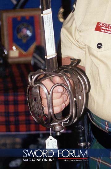

I was curious as to when the horseman's ring began to appear on basket-hilts.
(I guess this gives me a good excuse to post a picture of a Vince Evans basket-hilt Big Grin)

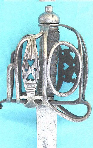

PostPosted: Wed 24 Dec, 2003 2:10 pm    Post subject:         Reply with quote
examples
 Attachment: 43.7 KB
 Attachment: 41.67 KB
 Attachment: 37.5 KB

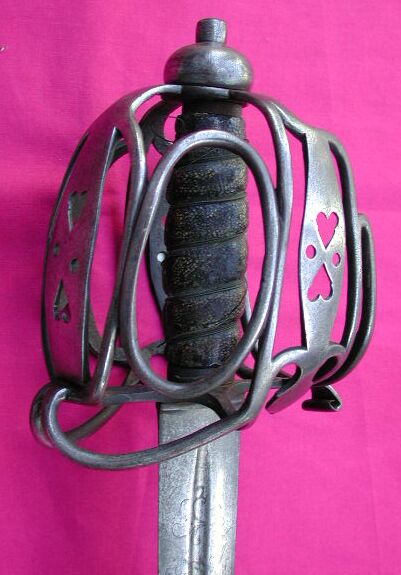

PostPosted: Wed 24 Dec, 2003 2:21 pm    Post subject:         Reply with quote
 Attachment: 91.8 KB
 Attachment: 9.67 KB
 Attachment: 48.63 KB

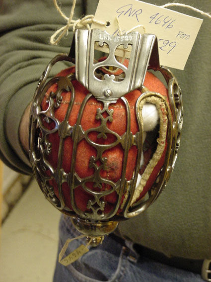

PostPosted: Wed 24 Dec, 2003 2:23 pm    Post subject:         Reply with quote
 Attachment: 31.09 KB

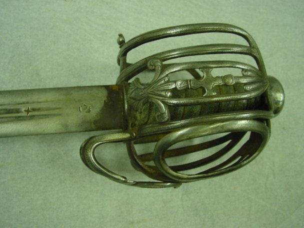

But I recalled an English basket from the Spring 1998 Wallis and Wallis Connoiseur Collector's auction that had a nice English basket that was dated about 1680. I have the catalog on hand, and sure enough, it does have the rein oval. It's not visible in the photo of the sword, but is in the description. The basket is formed of serpent-headed scrolls, and if I can get to a scanner, I'll post a photo.

PostPosted: Thu 25 Dec, 2003 7:13 am    Post subject:         Reply with quote
Hi Eljay
Is the basket your referring to the one in the upper left of this picture ?
Merry Christmas everyone ! Mac

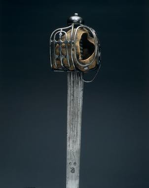

PostPosted: Thu 25 Dec, 2003 3:27 pm    Post subject:         Reply with quote
Another question .....
I wonder how many existing basket-hilts had a ring added, in later service, to equip them for cavalry useage ?
I found another early Scot example , this one by the great John Simpson (of Glasgow), in George Neumann's book
"Swords & Blades of the American Revolution" !
Mac

Thanks for your insight. That question has been bugging me for a while. Oh, and I finally figured out why the POS baskets are called 'Pinch of Snuff'.

Thomas,
The sword in the upper left of your posted photo is the one I was referring to. Now I don't need to find a scanner! There's two of these in existence, as Vince got to handle the illustrated sword's nicer twin on one of his England trips.
