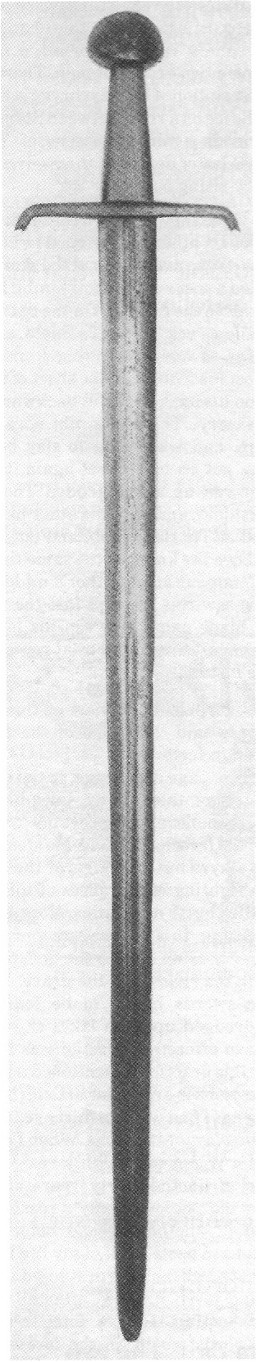

I have attached a scan of Figure 37 from Sword in Hand. I think that is the sword you are discussing, but I'm not entirely sure. Oakeshott's remarks state "It is in almost pristine condition". The fuller does seem to be somewhat rounded at the edges, but still seems to me to be well defined. Personally, I don't find this lack of razor sharp definition to be objectionable.
I notice that the blade profile becomes a little thinner about 2/3 of the way from the hilt to the point (?around the COP?). I wonder if this is from honing out some damage?

Though the picture is a bit small it is still helpful. I just think that is a really beautiful sword. I tend to think that this sword would have some taper towards the point irrespective of historical honing but I am not sure. Oakeshott does state that this sword did show evidence of extensive use especially in the point section which he described as "much rounded." I beleve that this sword would have had an adequate, though not severe point.

Sorry, Jeremy. I was trying to keep the image size under the 125KB limit for attachments. The full size of the image that I attached should be about 4.5 inches by 0.85 inches at 300pixels/inch resolution - were you able to get that size? The original scan (cropped to include only this image) is about 8.4 inches by 1.5 inches at 200 pixels/inch resolution, but the size, at 165KB is a little too big for a post attachment. I can email it to you, if that would help.
