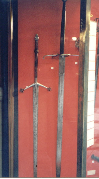

David Stokes
Joined: 23 Aug 2003
Posts: 250
PostPosted: Wed 27 Aug, 2003 10:42 pm    Post subject:         Reply with quote
Hi Mac
I was in Scoland in 2000, and spent the good part of a day in Kelvinsgrove Museum. More specifically in the arms collection.
I have TONS of pics from that collection, so i will try to post some if you like. I remember that claymore well because its the only TRUE two hander they have/ had on display. I always thought the grip looked a bit odd with the ball, but i must have been staring at the blade because i dont remember making a mental note of the oddly misporpotioned pommel, well it WAS 3 years ago..........
at any means im sure thats going to be a wonderful sword. The original was a sweet one. There are MANY swords in that collection and also at the culloden memorial museum that i wouldnt have minded playing with.......... sweet stuff.
David Stokes
Joined: 23 Aug 2003
Posts: 250
PostPosted: Wed 27 Aug, 2003 10:56 pm    Post subject:         Reply with quote
Ok, here it is, i found the picture and scanned it for ya,
It doesnt really add much to the conversation, but its better rez
I took many pics while in Kelvinsgrove, but sadly the ONLY pic i had someone take of me (beside THIS claymore actually) turned out so dark its barely recognizable as me, all you can see is my big smile.......... notworth posting....
 Attachment: 116.41 KB
