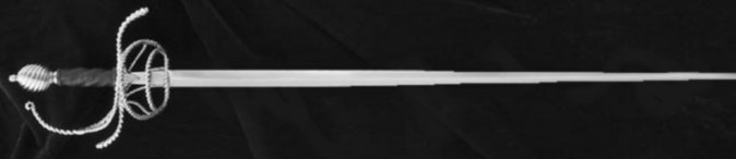

Just for fun, how do we categorize this sword?
 Attachment: 9.29 KB
HistoricalHandcrafts.com
Oakeshott Type XVIIID
Bill Grandy
Location: Northern VA,USA
Joined: 25 Aug 2003
Reading list: 43 books
Posts: 4,194
PostPosted: Thu 20 Jul, 2006 6:49 pm    Post subject:         Reply with quote
Heh, good call, I hadn't thought of that! And it actually furthers the point I was making because this picture is actually just a photoshopped image of an A&A Henry V hilt married to an A&A Writhen rapier blade. I did my best to keep it as close to scale as I could, too. Since I don't think anyone would argue that the Writhen rapier is in fact a rapier, I think this shows that a rapier blade has the potential to be more versatile than we give often give them credit. Depends on the particular blade, of course.

More photoshop fun (this time a little less well done). What is this sword? (bonus points if you know the exact two sword used to create this hybrid)
 Attachment: 8.74 KB

I wouldn't call the A&A Cavalier or A&A Dresden rapiers, myself. They have compound hilts much like other rapiers, but the blades are too stout. The Dresden, in particular, is a broadsword. It had the same basic profile and mass as the First Generation Albion Crecy that I owned. Perhaps it's better to class it as a Reitschwert. Who knows? As discussed, the term rapier is quite ambiguous.
PostPosted: Thu 20 Jul, 2006 9:06 pm    Post subject:         Reply with quote
As somebody else has said on another topic we do tend to want to a neat, orderly and consistent descriptions or definitions of these things. In part this is to be able to discuss them without ambiguities about what we are talking about.
I sort of agree that the Cavalier and Dresden are broadswords with complex hilts and I'm personally not very preoccupied by what to call them.

Oh, and by the way, the photoshopped "rapier" up there is the A&A Writhen rapier's hilt with the A&A German Branch sword's blade. The blade in it's normal context wouldn't be thought of a rapier blade, but it's really not so different than many rapiers:
