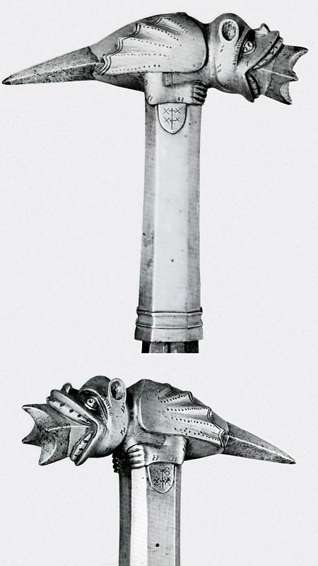

Included here is a photo of the antique hammer that inspired the (currently unavailable) Arms & Armor replica. It is Venetian, circa 1380.

One thing that catches my eye about this hammer is the different tone of both the spike and the striking tip of the hammer itself. Both of these pieces appear darker. Perhaps they are either differentially hardened, or actually different material all-together (perhaps higher-carbon pieces which were forge-welded onto the more elaborate body of the hammer head)?
Or perhaps the difference is purely ornamental?

It does look like a cap of some kind. I think you might be on to something. There's probably no reason not to make the main part (the "mass") of the head out of mild steel and then cap it with higher carbon sheet steel to help it punch through armour/people.
| Dustin R. Reagan wrote: |
Or perhaps the difference is purely ornamental? What are your opinions? Dustin |
Actually, the body is some sort of brass/copper-alloy, while the hammer face and back spike are some sort of iron/steel. Why you never see colour shots of this hammer is a total mystery to me.
Also, it is *big* - the A&A repro was about 2/3 the size of the original. The original also had a fairly short haft.

Thanks for the information! I purchased the A&A version of that hammer on ebay several months back but I really didn't know anything about it's provenance. Just looking at the pictures that Nathan posted I can say that there are some differences from the original. The sheilds on the sides are different, the dragons tail and "fire" are longer on the repro (proportionally at least) and I'm sure there are some other things. If I manage it I'll see about taking some pictures of the repro if you are interested. I don't have any information about other fanciful designs right off the top of my head the only one that comes to mind immediately is the "fist pick" attributed to Ziska...
