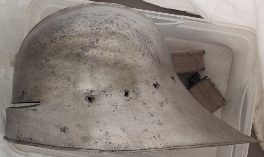

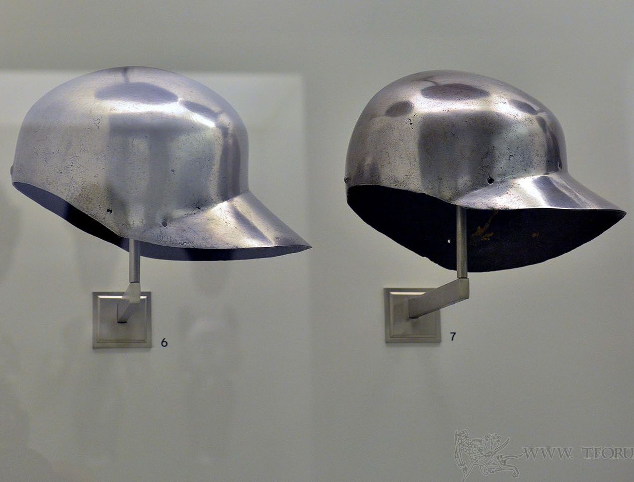

I often tell people, 'A sallet is not a salade is not a Schaller is not a celata.' they all have tails and are not burgonets, but they have strong regional differences. Here are a couple of Iberian examples and a German example to show how different they can be.
 Attachment: 102.71 KB
 Attachment: 109.16 KB
