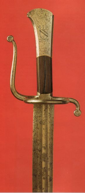

PostPosted: Fri 22 Sep, 2006 2:25 pm    Post subject:         Reply with quote
Here is the picture I promised, too bad the picture doesn't show the whole blade. A very elegant sword. The hilt and knuckleguard on the MRL looks to be too long, the proportions doesn't look as nice as on the original.
Hunting sabre bearing the owner's initials and the date 1658; German, made in the archaic 'Old Franconian' style which was fashionable at the time. Its blade is 76.8cm (30.25 in) long and single-edged.
A Collectors guide to Swords, Daggers & Cutlasses by Gerald Weland
 Attachment: 20.55 KB

PostPosted: Sat 23 Sep, 2006 5:12 am    Post subject:         Reply with quote
Thanks for getting the picture. You're right it looks like a very elegent sword. The proportions on the MRL don't look right and despite the fact I actually like the look of the MRL, it pales in comparison to the original.
I had the chance to handle two hunting swords whilst I was in Lindau, both a little more recent than the one in the book (early 1700's IIRC) Germany two years ago, but neither looked anywhere near as good as this one, although both handled very nicely. I wasn't allowed to take photos unfortunately. But I really like the way the wood is constructed within the handle as the metal curves round it to keep it in.
I think I might have to redesign the sword I'm thinking of getting made to incorporate some of the features on this sword Big Grin

PostPosted: Fri 20 Oct, 2006 4:37 pm    Post subject:         Reply with quote
AHA!! I knew I had seen this original sword somewhere before. This sword is A716 in the Wallace Collection. A716 has a shorter and wider blade, with less of a curve to it, compared to the MRL offering. A716 is just a much better looking sword! Comparison of key data in Nathan's post vs the Wallace Collection Catalogue:
Blade Length
MRL - 33-1/2 inches
A716 - 30-1/2 inches
Blade width
MRL - 1-1/4 inch
A716 - 1-1/2 inch
Weight
MRL - 2lb 10oz
A716 - 2lb 3oz.
- Sir Toby Belch
