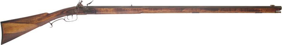

PostPosted: Sat 11 Nov, 2006 11:24 am    Post subject: I can't believe I missed this topic.         Reply with quote
I have lived entire life on the Southeast Kentucky/ East tennesse border, and know a little about the history and culture of the area.Early settlers were armed much the same as those in the other colonies, Muskets (fowlers,trade guns,and probably a few long land pattern brownbess's) and rifles of the Pennsylvania (kentucky)type.The rifles manufactured in the southern mountains were along the same line as the Penn. rifles (Many different schools of design) but much simpler ,simple or no patchbox, all iron fittings,no brass or carving,etc. but still just as effective as the "classic" penn. rifles.Flintlock hung aroud for a long time after the percussion cap was developed.After the civil war, the weapons in this area were much the SAME as anywere else, The barefoot , dirt poor "hillbilly" did and does, exist, is very much a stereotype exagerated at the turn of the century by northern newspapers(long story)The Hatfields and McCoys were fairly well off at the time of their feud .It is true that we were very isolated culturaly, that has never applied to fire arms.it is true that many HB's used very old fire arms, but most would find a way to acquire the best avaliable.Another point that has been brought is the ethnic make up of the Appaliachan(if you can spell it you not from here) people.The area is Mostly Scotts-Irish, with a lot of German, Welch, and sprinkle of English.The Scott-Irish and Gaelic/ Irish were and are entirely different people.
 Attachment: 33.61 KB
Tennessee moutain rifle [ Download ]
