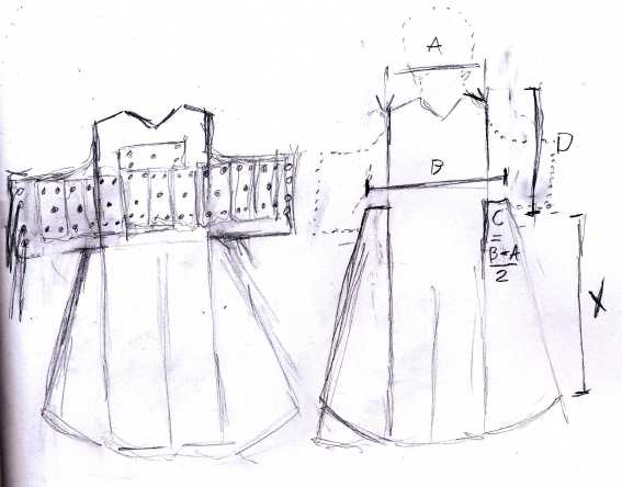

PostPosted: Mon 18 Jun, 2007 7:03 am    Post subject:         Reply with quote
Right-o. Here's a quick n' dirty pattern
A is the width of between your joints + a couple of cm.
B is half the circumference of your chest. (in my case , A is a about 35 cm, B about 50 cm)
C is the difference between A and B.
D is the distance from your the top of your shoulder to your hip.
X is the desired length of the surcote.
Start out cutting out the front and back pieces. Then attach the side flaps to the front piece, and rivet the plates in place. You do now have a "St Maurice / Apron style coat of plates/armoured surcote.
Now, make side gores as shown. They should be slightly longer than X, so that the top is under the plaps when its worn, and wide enough for you (and your armour) to pull it over the head.
In the back, sew them as normal. In the front, sew them up until you meet the flaps.
When you close the Coat of Plates, the result is as you can see in the pictures.
Make sure the plates are high enough to dive you freedom of movement. If done popperly, you shoudl have no weight on your hips at all.
Hope that makes a bit sense....

The steel is regular mild steel sheets, from a utility store; two 30x25 cm plates, divided into eight 10x25cm pieces with a hacksaw and metal blades
I can make no claim at being an armourer, so my main priority was to find out if it would work, and make it look as I could granted the fact that I was going to do it myself.
It's no repro, but It looks good, fits a lot better than my last attempt at making a CoP, and the concept seems to work like a charm.
I can, however, see the reasons for dropping the side gores, like on the St Maurice CoP.
The full armoured surcote must be pulled over the head before it can be fastened, which could be bothersome. I'v seen pictures of both kinds, so it was probably a matter of personal taste.
A 1250's norwegian description of a knight's armour states that the Plate should be worn on top of the arming coat, under the mail. In the same period we have sources on armoured surcotes; most likely the coexisted.
From what I can gather the plate was seen as an "extra" in the 13th century. After all, it offers no limb defense, and must thus be combined with other armour. And if you have a cloth armour and want to uppgrade, you will get the mail first; the CoP is almost as expensive, and covers less of your body.
So, once you have everyting else, a plate would be a good way to top it of.
Unfortunately, only the armoured surcotes are clearly visible, the other options beeing covered by surcote and possibly even mail....
