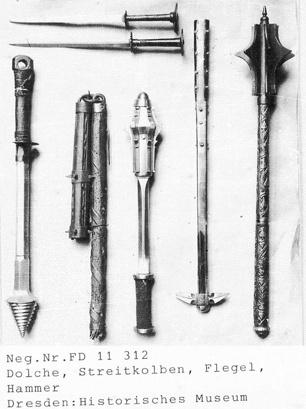

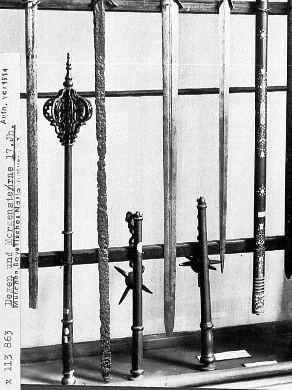

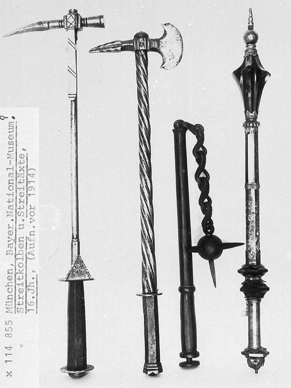

Here are some examples of antique flegel from the Bayerisches Nationalmuseum and the Dresden Historisches Museum
 Attachment: 57.28 KB
Copyright Bayerisches Nationalmuseum
 Attachment: 80.4 KB
 Attachment: 72.94 KB
Copyright Dresden Historisches Museum
