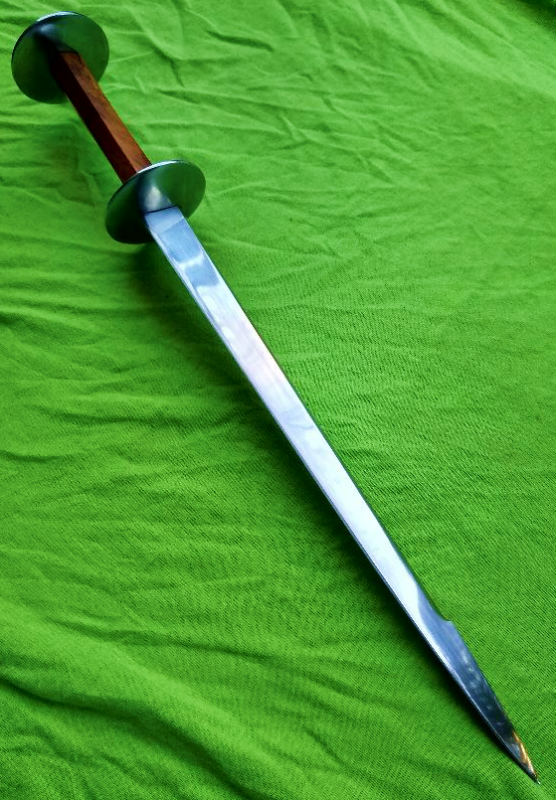

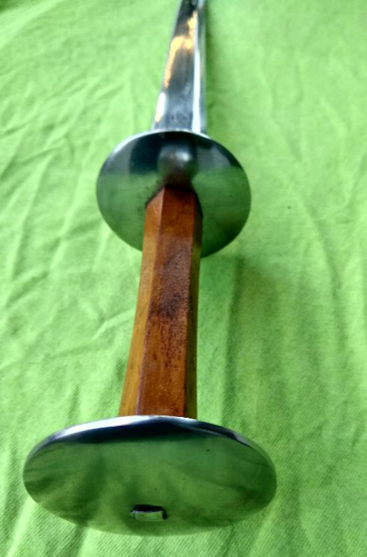

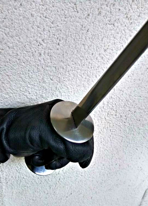

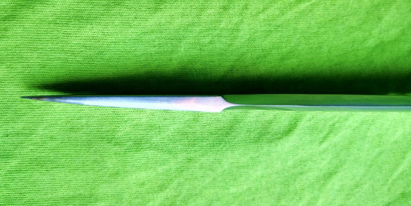

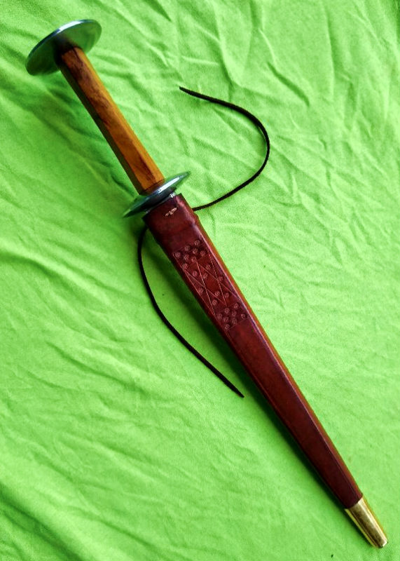

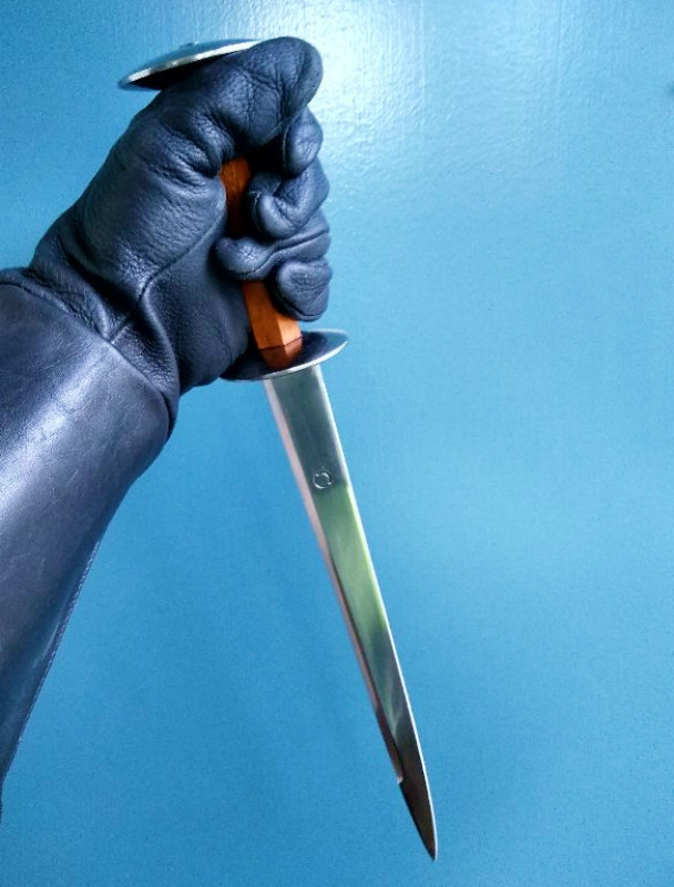

Here is the Tod Cutler 15th century Rondel. I received this a few days ago. It is one the pieces in Tod’s less expensive line, simple (certainly in comparison with some other rondels, which can be rather ornate) but very well made with interesting design choices. The rondels are hollow, convex shaped, each two pieces brazed together. This was done to keep the hilt lighter. The grip is wood with a hexagonal shape.
Specs – in inches
Overall Length – 17.25
Blade Length – 12.25
Blade Width – 1.00 at guard
Grip Length – 4.00
POB – 1.25
Weight – 12.9 oz.
The blade shape is interesting. The dorsal side is wider and blunt. For most of its length it has an inverted V shape (to cut down on weight?) Near the tip it flattens to help reinforce that tip. The blade has almost a concave shape as it narrows down to the sharpened ventral edge. And of course, it has a very formidable point. This dagger type was made to fight an opponent in plate armor, to pierce its vulnerable areas (armpit, groin, visor, etc.) with a point strong enough to go through the mail and padding underneath. Wearing one at your side was a mark of high status. You will find rondel daggers as part of the armament on many 15th century effigies and brasses. Like I said at the top, this is a fairly inexpensive piece of high quality.
