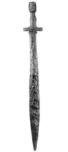

Can anybody provide me with a picture of an authentic historical xiphos--and by that I mean a museum piece, not a reproduction? All the pictures I've seen so far seem to be repros and shots of the same repro at that.

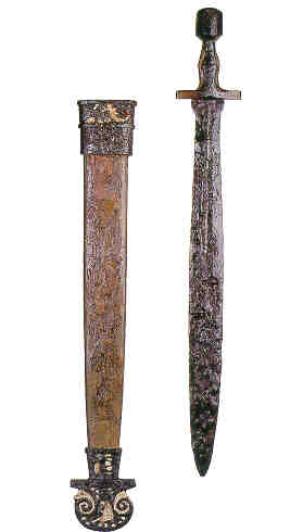

How about therse two found in South Italy?
(Greek colonies)
Attachment: 10.09 KB
Attachment: 4 KB
Lafayette C Curtis
Posted: Tue 16 Jan, 2007 2:07 am Post subject: |
Yes, those pictures are certainly very helpful. Thanks a lot!

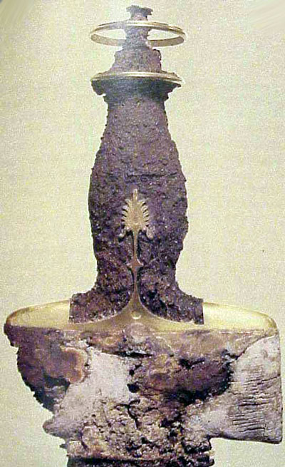

Here is a picture of the hilt of a sword believed by some to be that of Phillip II of Macedon (Alexander the Great's father). It was found in a large tumulus burial near the site of Phillip's royal city (Vergena?)

Ouch. That last one made me wonder about how the degradable components would have looked like if they had not been eaten away by rot and rust.
Peter Johnsson
Posted: Tue 16 Jan, 2007 10:36 am Post subject: |
| Lafayette C Curtis wrote: | | Ouch. That last one made me wonder about how the degradable components would have looked like if they had not been eaten away by rot and rust. |
Yes...
Note the large block of ivory that forms the mouth of the scabbard. This is a feature you can often see in vase painitngs: a rather massive looking mounting that seems to fit the guard with some kind of countersinking.
The same can be seen on Italic (and other?) bronze age scabbards. The mouth of the scabbard was shaped to fit the guard of the sword.
My impression is that this was a sort of inverted rain guard, mounted on the scabbard and not the guard of the sword.
The first sword I posted deos not seem to have this feature so well developed however.
