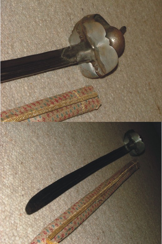

Hello.
I'm not native english speaker, so, sorry for my english.
I have a firangi sword (india arm with european, usually belgian blade) and I can not identify origin of a blade.
it's flexible (!), straight, blade is 98 cm, whole thing is about 130 cm tip is not sharp, but blade looks "hard used", cross-section is a triangle shape, but on the last 20 cm its double-egged. at the beginning of the blade it has a 3 grooves, wit one going to the tip. may be it's a wallon sword? can somebody take a look on the attached pic, or send me a pic/link to good quality photo of wallon sword (especially a blade)
Thanks
 Attachment: 105.48 KB
firangi

It sounds like some sort of backsword blade; but I cannot see any detail at all in the photos which have been posted. Do you have any other pictures of the blade?

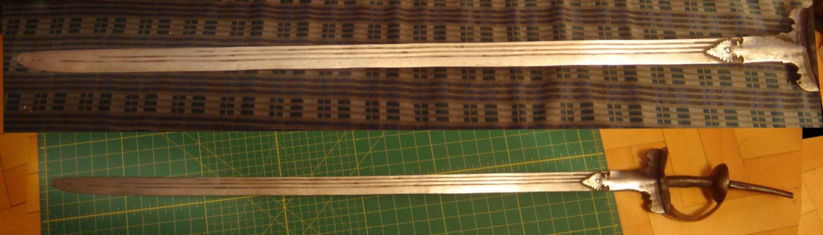

PostPosted: Mon 26 Mar, 2007 12:55 am    Post subject:         Reply with quote
I think Khanda is wider and more massive, double edged and usually rhombus.
my one is one edged, triangle and flexible from the hilt to the tip.
It can be some other type of indian sword, (no one can count all ways they curwe any pice of metal they grabbed Happy )
but most probabely it is a firnagi sword, and you are right, that means "european".
 Attachment: 84.84 KB
Jonathan Hopkins
PostPosted: Mon 26 Mar, 2007 5:18 am    Post subject:         Reply with quote
Kerim,
The sword in the photo is an English basket-hilted dragoon sword from c.1740. Here is a thread about that sword with some better photos: http://www.myArmoury.com/talk/viewtopic.php?t...asket+hilt
Scroll down for more detailed pics and information. As I said in that thread, I believe that the blade is of German manufacture as it is stuck with what appears to be a king's head mark.
Jonathan

PostPosted: Tue 27 Mar, 2007 5:57 pm    Post subject:         Reply with quote
That one looks pretty much like my one!
next question - is that english dragon sword flexible?

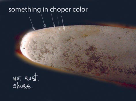

when I say "flexible", I mean it's bending a little bit, but I'm not trying to brake it Happy just a little try, 1-3 degree. just to see that it can bend.
another thing - something in copper color shows under metal (nearly unreal, I now) and it's not a rust.

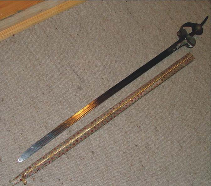

Kerim Mamedov
Location: Poland
Joined: 21 Mar 2007
Posts: 53
PostPosted: Wed 28 Mar, 2007 12:11 pm    Post subject:         Reply with quote
My one is elastic - up to 15 degree with out any problem, and you are right - I can bend up to 3-5 degrees other blades (yatagan, chespot bayonet, kyu gunto) but this "probabely dragon sword" is much more elastic than others
 Attachment: 49.51 KB
 Attachment: 99.21 KB
