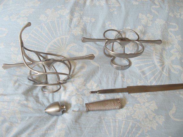

In a spirit of conciliation, I decided to order both Big Grin So I chose a 3 ring swept I guard and a two-port cross guard I, according to Darkwood's terminology. Other details include acorn pommel, wire wrapping and straight quillons with three-lobed tips. I sticked with the standard finish as it was not meant to be ornemental at all.

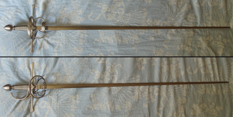

The blade, as I said, is 42 inches, so 106.7cm, and the overall length, pommel to tip is 121cm. The quillons span is 25cm on both hilts. The blade is a bit more supple than what would be expected, I think, of a true weapon, but that does not really affect handling. Despite the blunt tip it is quite capable of piercing already, so if it was sharp, it would still definitely be a dangerous weapon...
Changing hilts is really easy, and once the pommel is screwed back the assembly is very tight. There are grinding marks on the hilts and blade, of course, but the finish is quite pleasant, which is just what I expected. And any sharp angles that could be dangerous for the hand were removed carefully.

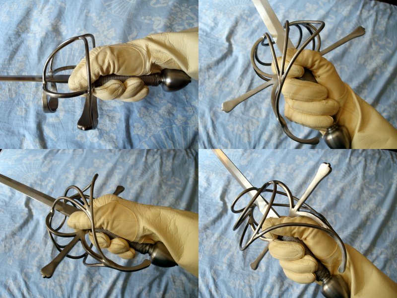

This rapier already allows me to experiment with the various grips, and I have found that Thibault's grip can indeed be practiced with a swept hilt as seen in the photos below. I'm unsure however that it allows the full range of motion that Thibault uses, but I'll have to study it further...

 Attachment: 122.95 KB
Various grips. Top-left: Thibault's grip (index over the false edge quillon, thumb over the true edge quillon); Top-right: the common rapier grip; Bottom-left: Thibault's grip on a swept hilt, the knucklebow faces left; Bottom-right: a cut with Thibault's
 Attachment: 69.41 KB
The parts of the sword.

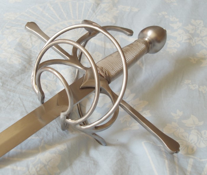

 Attachment: 87.25 KB
Perspective view of the swept hilt.

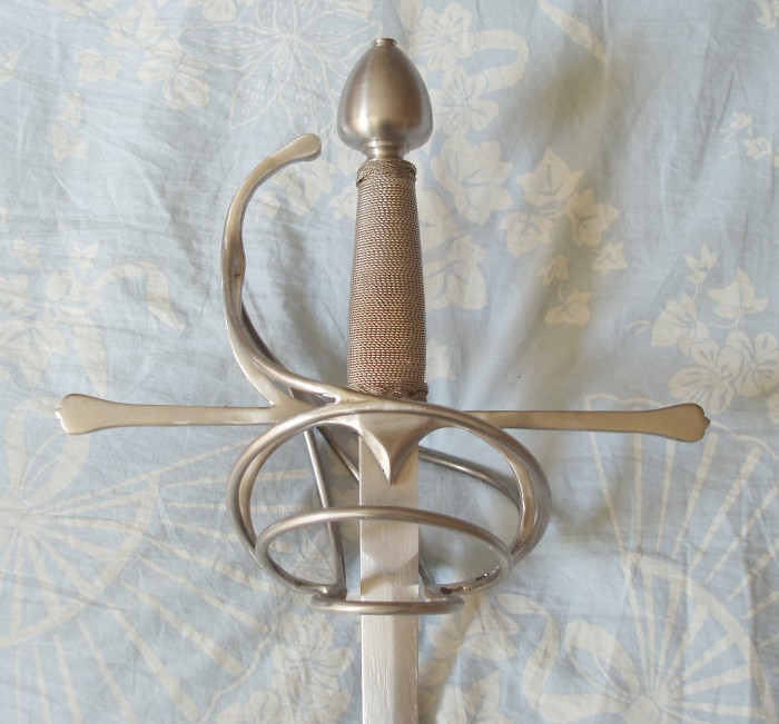

 Attachment: 103.73 KB
Front view of the swept hilt.

 Attachment: 94.78 KB
Front view of the half hilt.
 Attachment: 88.48 KB
Overall views of the sword, top: half hilt, bottom: swept hilt.

I only just realize that the caption of the picture with the hand positions seems to have been truncated, here is the full text:
Various grips. Top-left: Thibault's grip (index over the false edge quillon, thumb over the true edge quillon); Top-right: the common rapier grip; Bottom-left: Thibault's grip on a swept hilt, the knucklebow faces left; Bottom-right: a cut with Thibault's grip, the thumb goes on the other side, the knucklebow can go as far as touching the base of the thumb.

That being said, I have tried many moves and positions on my own, and so far I haven't come across one that is absolutely impossible to perform with the swept hilt. But Thibault's work is huge, so maybe I missed something. I'm fairly certain all the basic moves at least work with a swept hilt held as I do in the bottom images of the first attachment. However, if you want to practice specifically Thibault having a half-hilt is probably preferable... The knucklebow is about useless in that position anyway.
If I had to buy a rapier now with a swept hilt, I would change the counterguard or inner guard, specifically the way it is attached to the rest of the hilt. On many swept hilts the counterguard is linked to the knucklebow. This is the most obtrusive part when you try to throw cuts according to Thibault's instructions. I think a hilt where the counterguard is attached to the cross would be preferable, I don't remember Norman's number for that now...
Right now I'm fairly convinced that the optimum compromise between my artistic preferences and Thibault constraints is Norman type 74, like this one. Beautiful sweeps on the outside and a relatively small unobtrusive inner guard...
