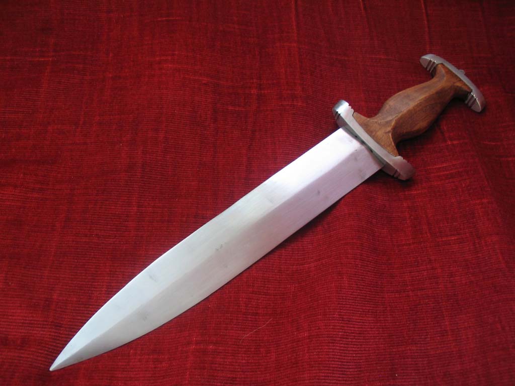

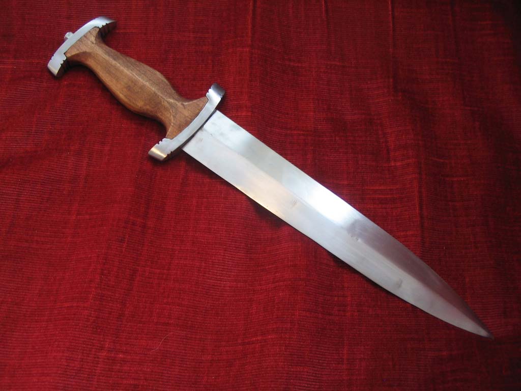

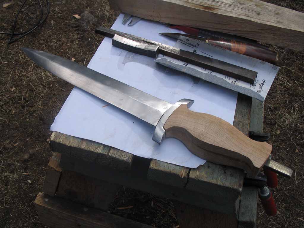

I've been unusually productive lately...guess I've had nothing better to do, so here's a Holbein dagger I made last week. This was sort of a modification project, cause I had a big two-handed sword to sacrifice for this project. That sword was actually the first one I've ever made. It was made from a leafspring, like most of my recent blades. It was not historically acurate at any way(well, maybe something can be found if you use your imagination)and the whole construction was a bit poor.

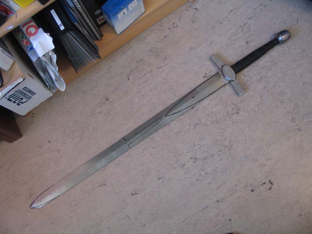

A few words about the great sword:

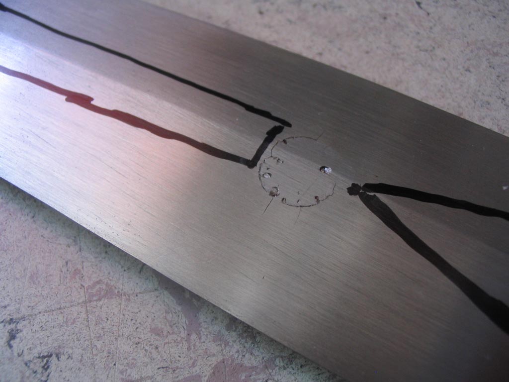

Since the blade was made from a big leafspring, it had the mounting hole in the midlle of the blade. Back then, I straightened the blade without any kind of heat treating, and welded the hole. Due to this it wasn't going to be very durable in the first place, and eventually the blade started to curve back to it's original bended form. The crossguard was also welded together, like the pommel to the end of the tang. It wasn't too hard to dismantle the sword with a big hammer Razz
In the picture you can see the whole sword and the modification plan drawn to the blade. I thought that I would make two daggers out of it. One bigger, and other a bit smaller. I was gonna get rid of the welded hole by leaving it between the new blades, as seen in the picture. There's also a picture of the welded hole. You can see how it had started to crack around the welding.
On we go...
I cut the blade in two, and roughly shaped the two new blades. Then I heated and starightened the blades to remove the tension from the leafspring. When I first draw the new blades on to the old one, I thought the smaller was going to be a Holbein(didn't know the name back then...just remembered the looks somewhere). I continued working with the Holbein since I had no time to do both. The bigger daggerblade is still waiting for some more planning. Propably it will be more like a small sword, rather than a dagger.

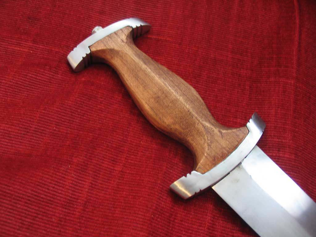

I had pictures taken from the internet, which I used as a reference to make the Holbein-dagger. This project might be historically the most accurate, considering the items I've made so far. I had no spesific measures, so the proportions are roughly based to the pictures I had. The blade might be a bit too wide, and the handle a bit too long...but not still too far from the historical, I think. The tang is riveted with a nut. I believe the tang on the original dagger is threated, but since I had no proper tools for that, I took a little shortcut.

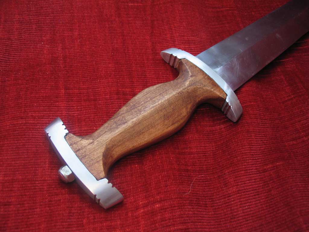

Again I bathed with blood, sweat and tears trying to make a square hole to the crossguard with my, yet so famous, "simple tools"...Meaning electric hand-drill, and small file. In whole, the project took me about three 12-hour days to finish.
I'm planning to make a scabbard for this dagger too, but I haven't gone any further with that yet. Oh, and the handle is made of dyed ashwood...it could have been something harder, I think...and the blade could still be polished a bit more
Some measurements:
OA length: 39cm
Hilt length: 13cm
Blade length: 25,5cm
Blade width: 4,2cm
CG Width: 8cm
Any comments are welcome, as usual.
Enjoy(or don't, if you dislike it)
Wink
-T

I am not all that familiar with Holbein Daggers, but I have nver seen the sort of file work on the pommel and guard that you have done. I rather like it and am wondering about its historicity.

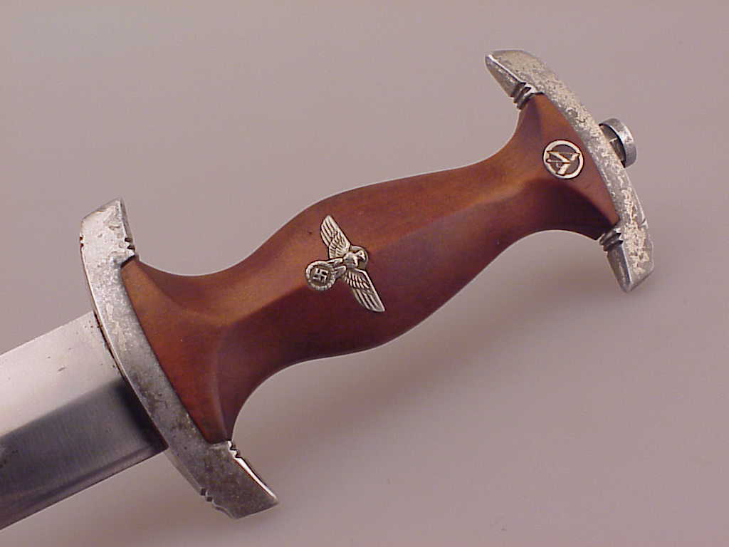

I guess the filework I've done here is mostly based on the WWII german style holbein, from which I found more pictures of...and close-up pictures especially. One picture attached. The original holbeins might have been without this kind of details(?) Well, anyway, it was easier to find pictures of the german ones.
-T
Thirties Holbeins were made in Solingen on old renaissance patterns, however the filework appears very "forties" in style.
Despite this your dagger is pretty beautiful and I really like it.
I see that the modern models were also electroplated (argh).
Most likely the blades of such modern replicas were also aursforged, as Hrisoulas has stated in his books that ausforging was teached to him by an old german man who had worked all his life forging army blades in Solingen.
Also some of such modern Holbeins were pattern welded, and this are the last years of pattern welding for Italy too.
