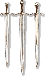

Illustrations of three Type XIV
swords by Peter Johnsson

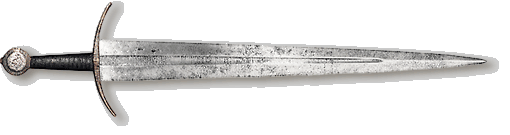

XIV.1 From the Metropolitan Museum, New York
Perhaps the best known example of a Type XIV sword is housed in the Metropolitan Museum in New York. It is in excellent condition and is the first sword Oakeshott uses in Records of the Medieval Sword to illustrate the type. The inlay in the fuller of the broad blade is similar to other surviving swords (most notably the sword of Sancho IV of Castile), making the sword dateable to the second half of the 13th century. The tip portion of the blade has a pronounced diamond cross-section which is somewhat atypical of the type. The bronze pommel bears a latin inscription on silver band bands, Sunt hic etiam sua praecuna laudi, which translates as "Here also are the Heralds of His Praise." The guard, according to the museum, is of copper covered by silver wire; a technique seen commonly in the Viking era.

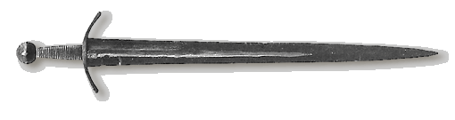

XIV.2 From the Royal Armouries, Leeds
This sword, found in a peat-bog in Northern Italy, is in pristine condition. The broad blade and stout proportions give the impression that this is a heavy, unwieldy weapon, but it is actually light and agile. The fuller is rather long for this type. The blade is marked "TOTOTOTO", an inscription often found on 13th-14th century rings and indicating an affirmation of loyalty and fidelity.

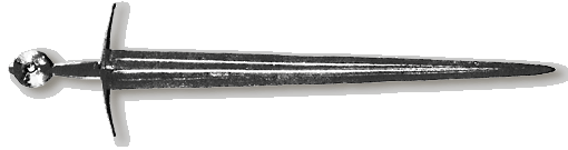

XIV.4 "Moonbrand", in the Oakeshott Collection
This sword was very special to Ewart Oakeshott and was a cherished part of his collection. It is frequently seen in his hand in photographs and frequently accompanied him on the lecture circuit. It is featured in Records of the Medieval Sword. Its hilt is made of iron plated with silver, and unlike many river-found swords, it retains its original grip of leather-covered lime wood. The red leather has darkened over the centuries to black. The broad blade has four fullers, extending nearly half the length of the blade. Oakeshott describes the blade as being "very thin in section from about half-way down stiff yet flexible and still very sharp."
