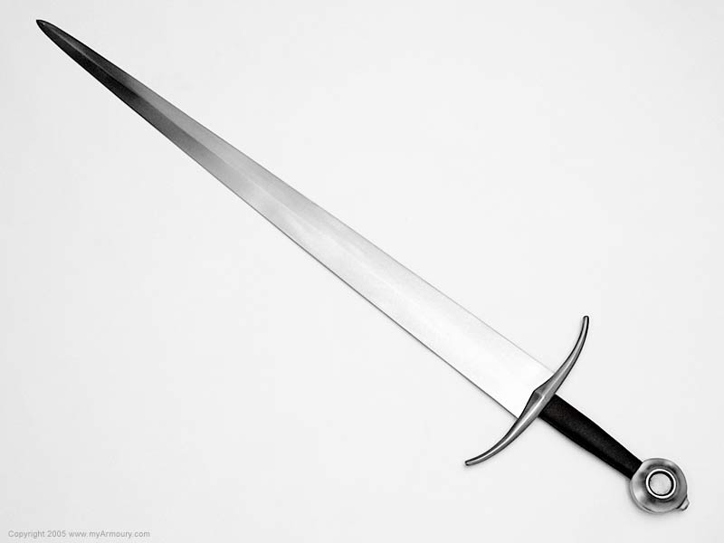

Arms & Armor of Minneapolis, MN has long produced high-quality reproductions of historical swords. In some cases, they have been able to use Ewart Oakeshott's notes in the design/redesign of their products. Many of their models have been in production for years, though they tend to quietly improve and upgrade their products every few years. One of the newer additions to their sword lineup is the French Medieval Sword. Based on a sword dated circa 1375-1400 in the The Wallace Collection (A.460), it is a good example of a sword whose blade type changed throughout its working life. Oakeshott classified this sword as a Type XV based on its current blade shape, but seemed sure that its shape had changed through repeated, and severe, honing. A&A chose to recreate this sword as it probably left the cutler's shop, giving it a blade with less acute taper of Type XVIII form.

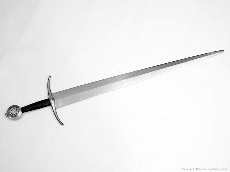

Click to enlarge
Weight:2 pounds, 15.25 ounces
Overall length:37 inches
Blade length:29 1/4 inches
Blade width:2 1/2 inches at base, tapering to 7/8 inches
Grip length:4 1/2 inches
Guard width:8 3/8 inches
Point of Balance:3 inches from guard
Center of Percussion:~18 inches from guard
Oakeshott typology:Type XVIII blade, Type J1 pommel, Style 7 (?) guard
Replica created by Arms & Armor of Minnesota.

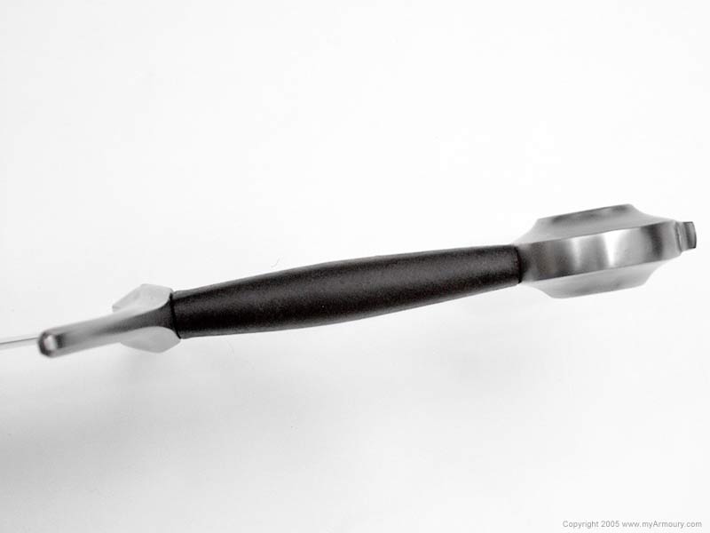

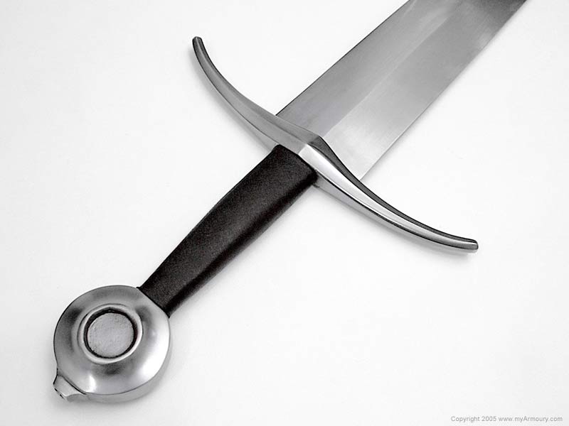

Click to enlarge
Viewing the subtle shaping of the guard
Arms & Armor's swords feature historical characteristics wherever possible. On this sword, that resulted in a grip that is slightly smaller than I'm used to handling. I found the grip to be a little too thin and narrow for my large hands to grasp comfortably in the hammer grip. My hand cramped up a little within a few swings. Once I adjusted to a less firm grip, more like the "handshake" grip often used with Viking swords, my comfort improved a great deal as did my cuts. I'm sure Arms & Armor could make a slightly thicker grip, at a customer's request. The grip allowed plenty of room for my right hand.
With a Point of Balance relatively close to the cross, I expected this sword to lack some blade presence. What I found instead was a sword with nimble control and a pleasing amount of blade presence. I had no difficulty keeping the blade in line during cutting and experienced no vibrations unless my technique was off. This sword cut well against light targets. When thrusting with the sword, it was very easy to put the tip where I wanted it to go.

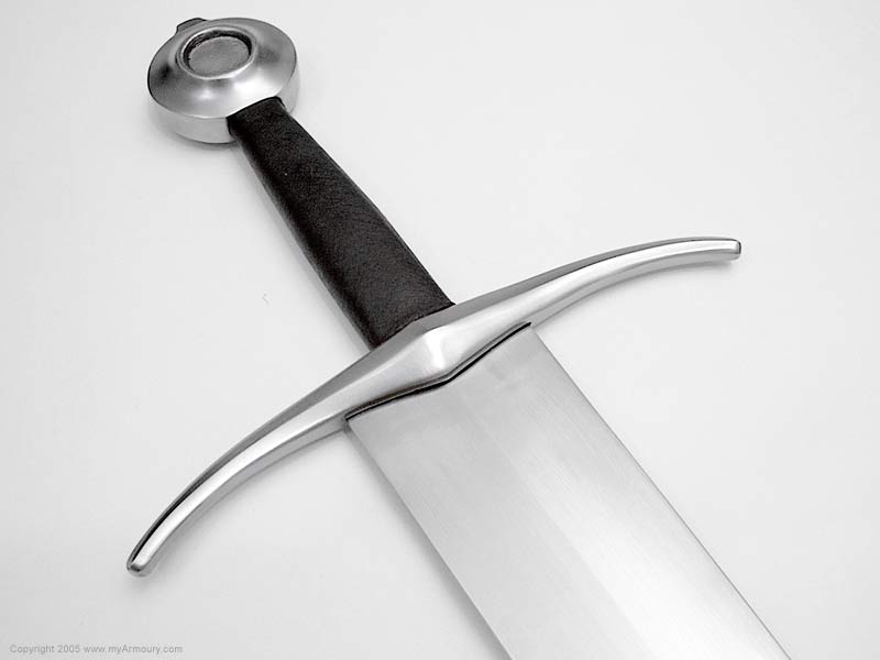

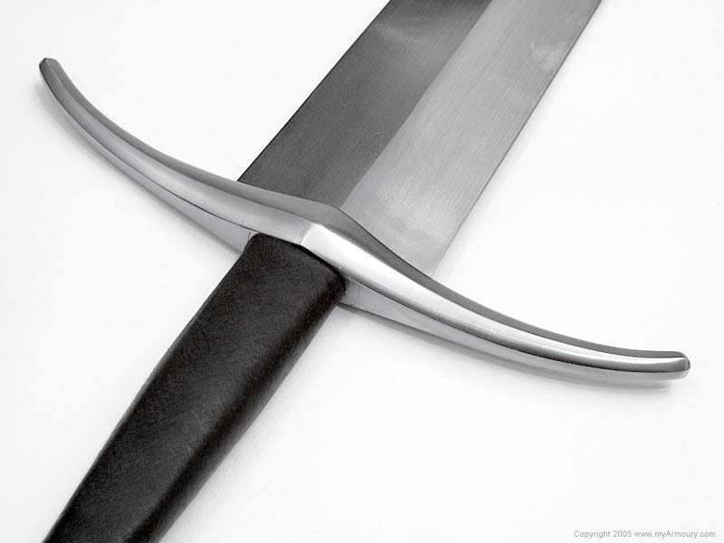

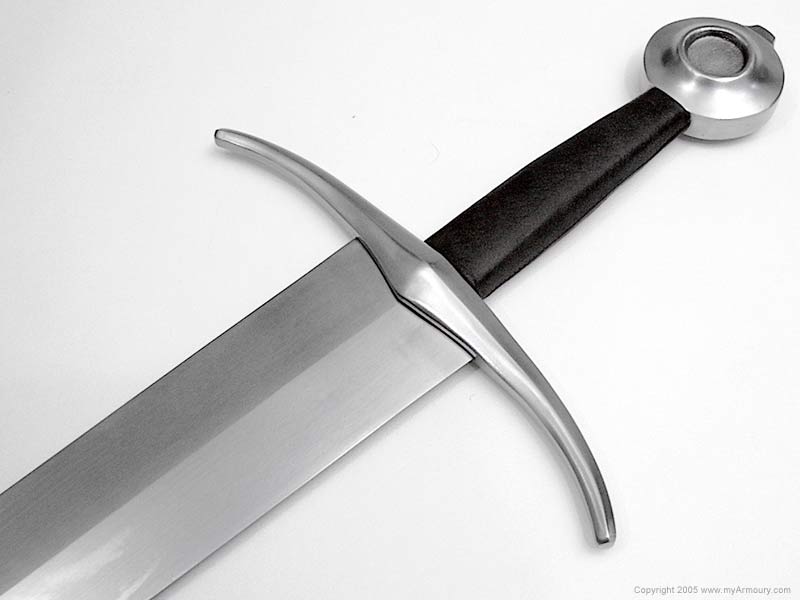

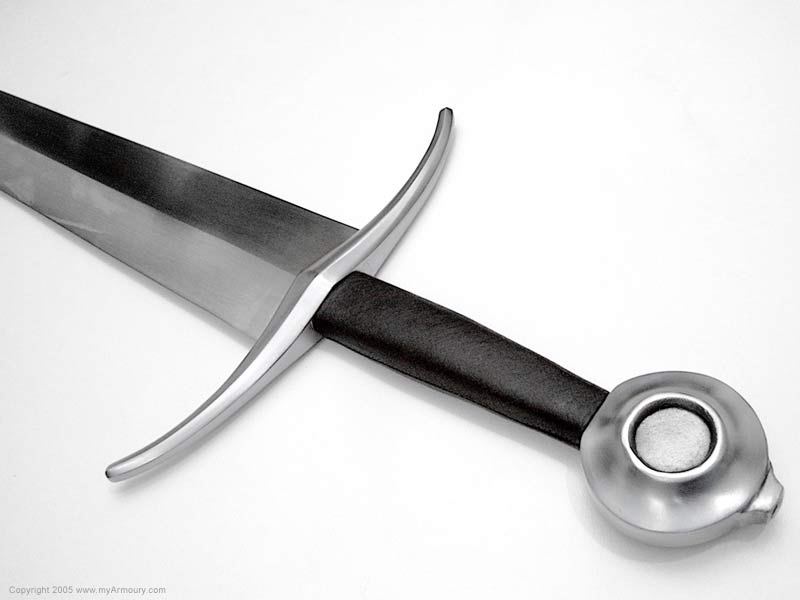

Fit and Finish

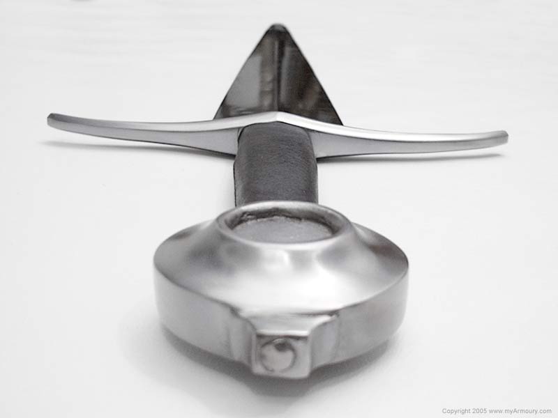

Click to enlarge

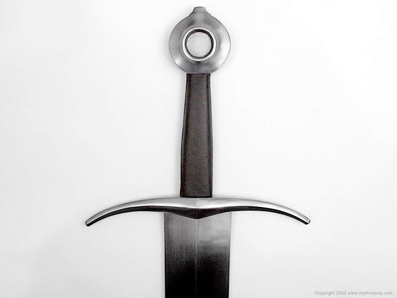

Viewing the sword from the pommel end
Both hilt and blade are finished to Arms & Armor's standard matte satin finish, which is historically accurate and attractive and should be easy to maintain. The detail on the cast hilt components is not as crisply defined as some swords on the market at a slightly higher price, but the look is still very authentic and keeps the price down. The cast hilt components are well executed with no major pits or casting flaws.
Many historical swords featured rivet blocks atop the pommel over which the end of the tang was peened. On this sword the rivet block is cast into the top of the pommel. I'm sure this was done to save cost to the customer and eliminate a step in the sword's assembly; nevertheless, I would have preferred for it to be a separate piece for purely aesthetic reasons. The cross is hexagonal in cross-section and is well-defined.
The Type XVIII blade is of flattened diamond section. Its median ridge is straight and even throughout the blade's length. The blade tapers gracefully in profile, creating a shape that shows its purpose: it is wide at the Center of Percussion for powerful cuts, yet tapers to a strong point for thrusting.
