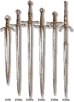

Illustrations of Type XVIII swords and
its subtypes by Peter Johnsson

Properties of the XVIII and its Subtypes
In order to avoid block quotes, the descriptions below simply paraphrase Oakeshott's extensive written descriptions.
    Type XVIII
  • Broad blade: 2-2.5" (5.08-6.35cm)
  • Flattened-diamond cross-section along entire length
  • Slightly convex, tapering edges
  • Sharp point
  • Medium-length grip of 3.75-4" (9.52-10.16cm) with raised central portion
  • Pommel of wheel or scent-stopper form
  • Curved cross
    Type XVIIIa
  • Fairly slender blade, sometimes with narrow fuller in upper portion
  • Cross and pommel of any type
  • May be very large, with grip length of 5" (12.7cm)
    Type XVIIIb
  • Slender blade
  • Extremely long grip of 11-12" (27.94-30.48cm) and of distinctive, waisted shape
  • Usually straight cross
  • Pommel may be of fruit, wheel, or scent-stopper form
    Type XVIIIc
  • Large, hand-and-a-half sword with blade up to 34" (86.36cm)
  • Faces of the flattened diamond section may be slightly convex
  • Long grip with a pronounced bulge in its middle
  • Cross often horizontally S-curved
  • Pommel usually of wheel form
    Type XVIIId
  • Slender, stiff blade, sometimes with fuller almost the entire length of the blade
  • Cross-guard is often horizontally S-curved or sharply downturned
  • Hilt may feature pas d'ane and siderings
    Type XVIIIe
  • Narrow, flattened-diamond section blade
  • Blade generally has a long ricasso significantly narrower than the rest of the blade
  • Very long grip
  • downturned cross
  • Pear-shaped pommel
