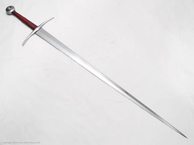

With their popular Next Generation line Albion Armorers has introduced an impressive batch of medieval swords designed through careful research of period originals by Swedish swordsmith Peter Johnsson. One of their newest offerings is an Oakeshott Type XVa sword they call the Agincourt, after the location of the famous 1415 battle which England won over the French army. The name is appropriate as it refers to a time where Type XVa swords were popular.
Click to enlarge
Weight:3 pounds, 6.7 ounces
Overall length:46 1/4 inches
Blade length:36 1/4 inches
Blade width:1 7/8 inches at base, tapering to 3/8 inches
Grip length:7 1/4 inches
Guard width:9 1/2 inches
Point of Balance:3 inches from guard
Center of Percussion:~18 1/2 inches from guard
Oakeshott typology:Type XVa blade, Type K pommel, Style 7 guard

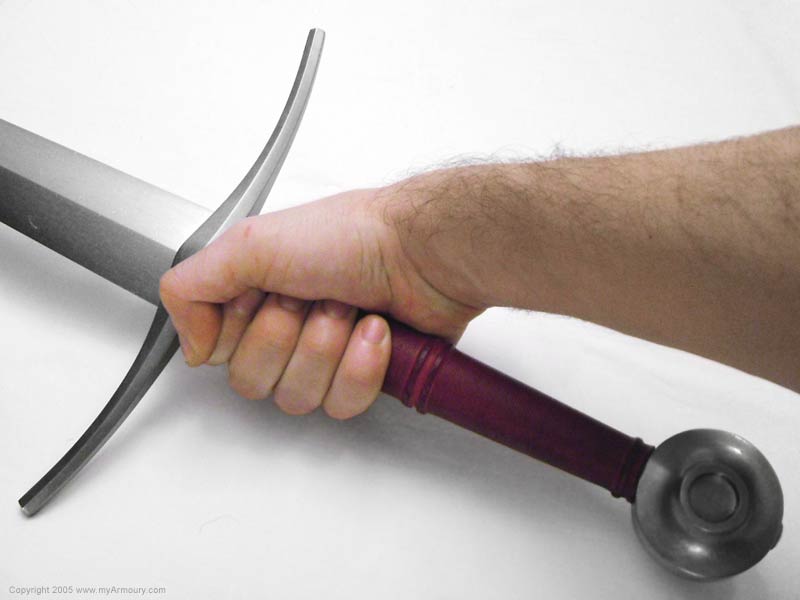

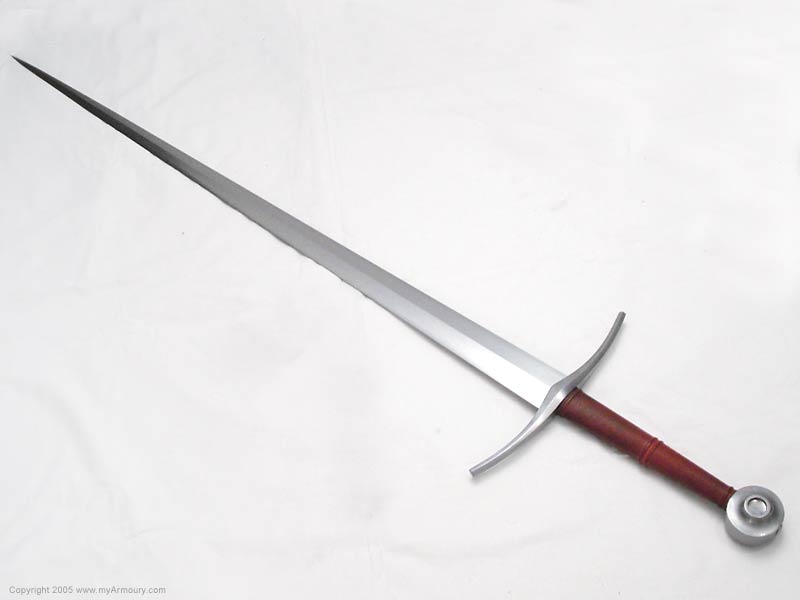

The two-dimensional look of this sword belies its heft and blade presence. At almost 3.5 pounds, this sword is no lightweight but its mass is not apparent when set in motion. The sword tracks well and this optimal tracking is easy to obtain. Because of its careful mass distribution, with much of the mass being concentrated close to the hilt, the sword is fast to set in motion and quick to recover. However, the sword still has a surprising amount of blade presence which would make it a good cutting sword as well. Though no actual cutting was done with the sword at the time of this review, it is expected that it will perform well though it will likely be less forgiving and require more effort to deliver amputating cuts when compared to more cutting-oriented types like the Type XIIa and Type XIIIa.
The blade is very stiff and sturdy and together with the strong point they make the sword a very potent thruster. Changing guards with this sword is very easy and fluid. The long grip and forward pivot point of this sword (within an inch from the tip) make control very easy and give the feel of a natural extension of the hand during thrusting exercises.
The thick narrow blade is perfect for half-swording. When the blade of the sword is securely grabbed with the off-hand, half-swording techniques are easily and safely executed, though the author only attempted such exercises wearing thin leather gloves. The sword can be used with one hand, though (at least in the author’s hands) the full potential is only unleashed when gripped with both hands.

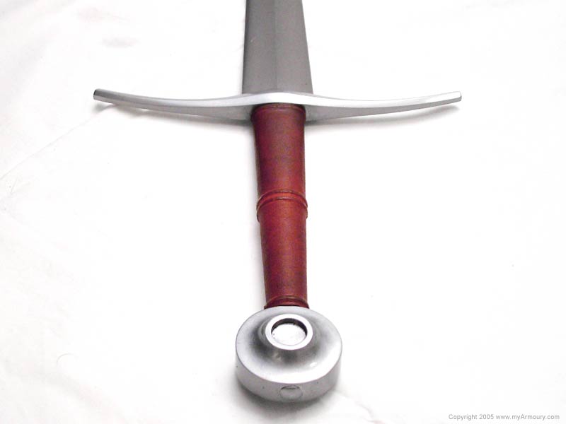

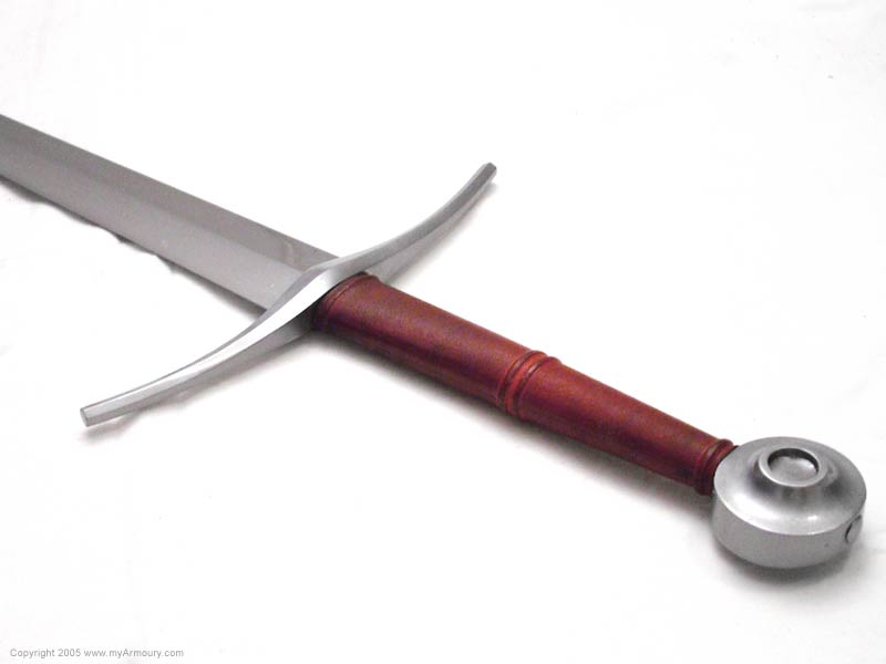

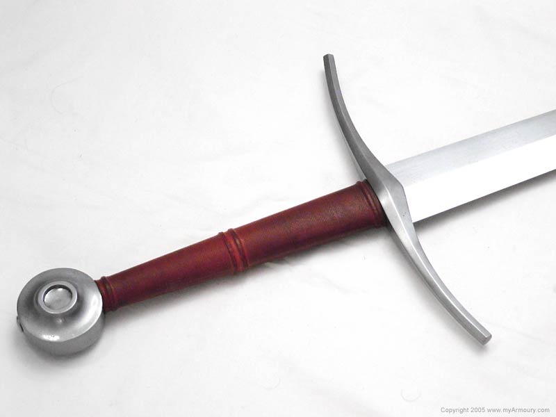

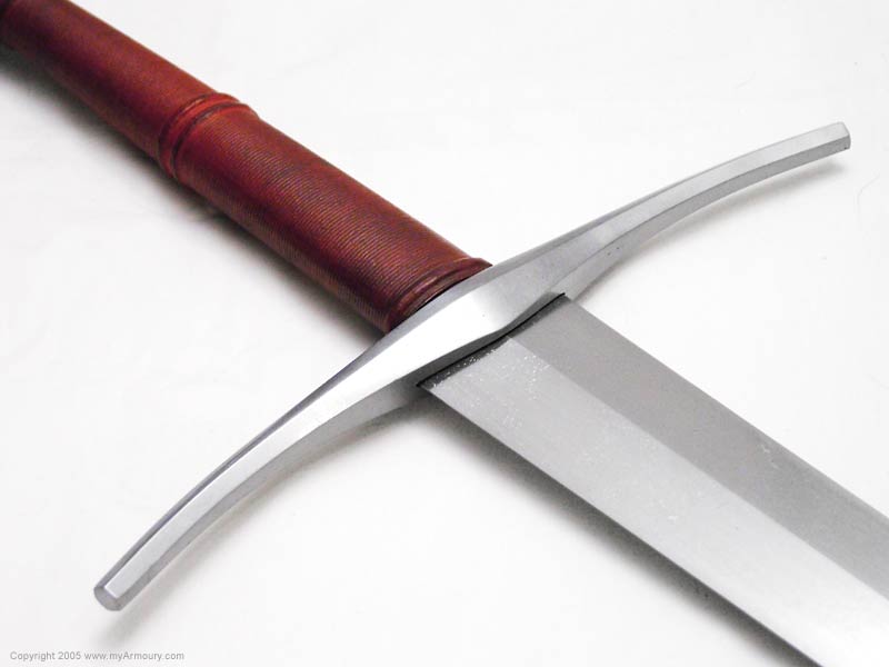

This sword stands true to the quality we have come to expect from Albion. The sword arrived well packed with no rusting or damage. The usual satin finish that they use on their swords was very evenly executed, and nicely underscored its crisp and well-defined lines. The sword is securely assembled and there is no rattling during dry handling.

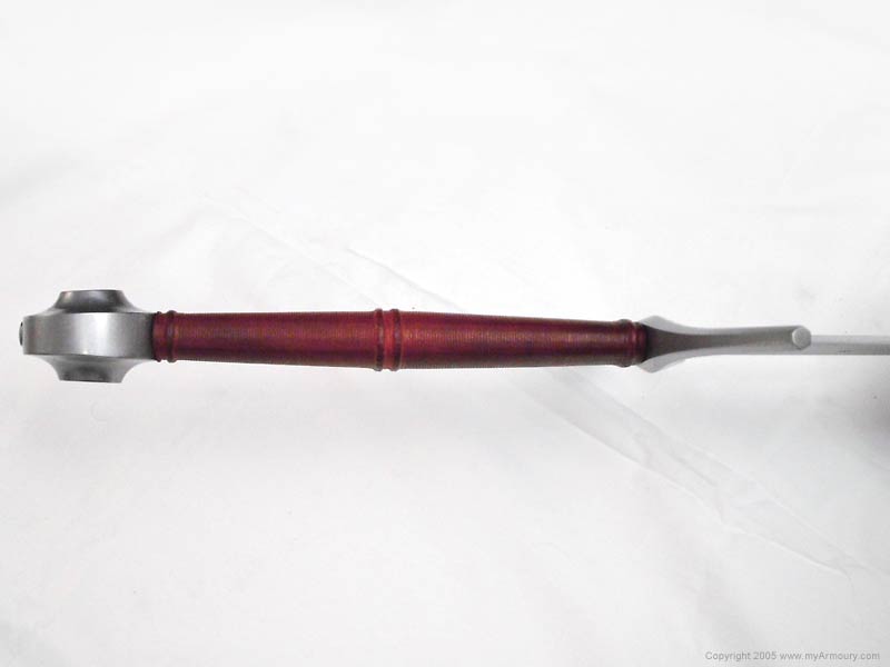

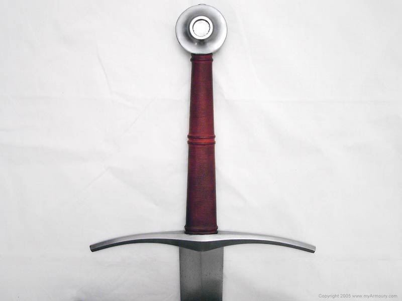

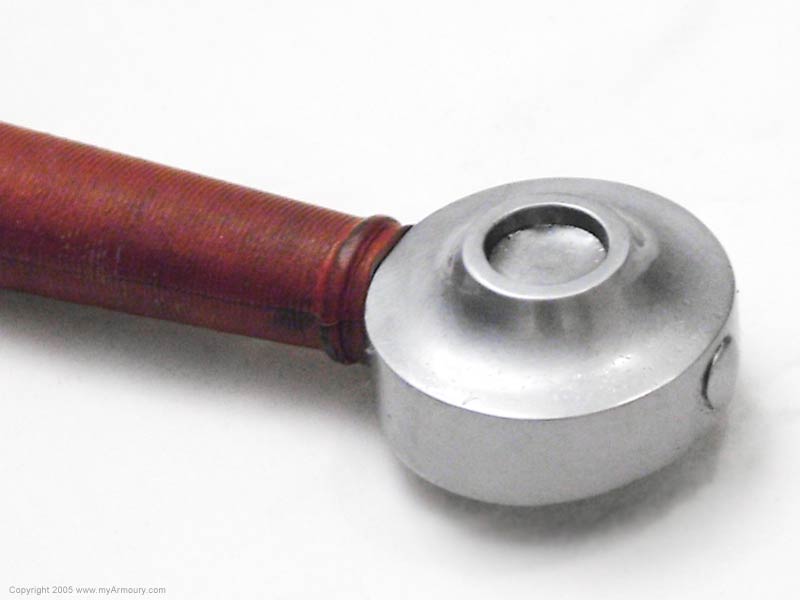

The guard fits very snugly around the blade. The pommel is amazingly attractive. It is interesting to see how careful use of simple volumes and shapes can generate very visually pleasing objects. The investment cast pommel has an even finish and the few small pits from the casting add a great deal of character to the overall look of the hilt. The peening atop the pommel is nicely executed into a dome shape formed directly over the pommel. The grip features four risers placed between the wooden core and the leather that covers it. Two of the risers are at the ends of the grip, and two are in the middle. The leather's seam was barely visible.

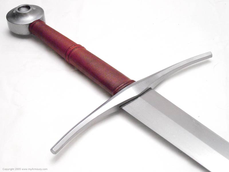

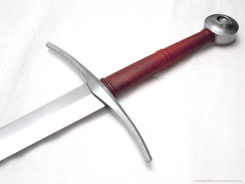

The gently curving guard of the sword was well executed. It features a hexagonal section at the tips and swells towards the middle. This guard style is generally considered to be typical of Anglo-French weapons as opposed to the Italian fashion which has the ends of the guard sharply turned down (as on the sword attributed to the Black Prince). A beautiful example of the style of guard and pommel used on the Agincourt can be seen on sword A.460 from The Wallace Collection, thought to be of French provenance.
