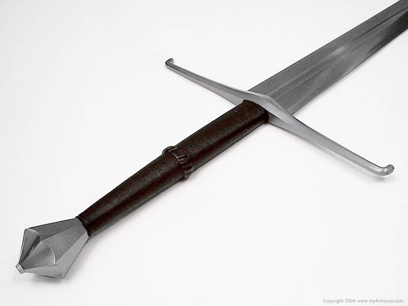

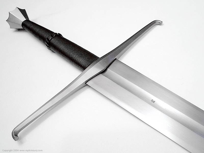

By the mid-15th century the medieval longsword had reached the pinnacle of its development. Armor had reached a level of effectiveness that rendered the earlier styles of longsword obsolete. A sword was needed that could deliver a decisive thrust yet still deliver an effective cutting blow. Swords maintained an acute point, but an emphasis on cutting that had been neglected in the designs of the previous century returned. This is shown in the broader cutting surfaces that are evident in the longswords of the 15th century. The Brescia Spadona is an excellent example of this trend. The Brescia's blade features an acute point that is designed for the thrusting techniques outlined in the period manuals. This point flows into a broad cutting surface that is well defined. The blade features a broad secondary bevel that is cleanly executed, and adds visual detail. This bevel is a feature of the original, and is necessary to maintain the appropriate combination of edge geometry, strength, and mass distribution. Albion's head Cutler Eric McHugh commented on the blade's design, "There is a small but noticeable secondary bevel on the Brescia blade. It is a wide secondary bevel, too. So this is what you are seeing. This is one of the features of the original. In photos of the original, you can just make it out when the light plays on the blade, but that is the hint that it is there." The blade also exhibits a cleanly executed narrow fuller that runs nearly half the blade length. At the fuller's end, the blade transitions into a shallow diamond cross-section. This cross-section combines with the secondary bevels at the tip, which results in a point that is properly reinforced for use against armored targets.
Click to enlarge

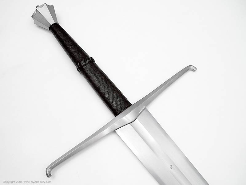

Pommel Detail
Click to enlarge
Grip Detail
Collector Chad Arnow was impressed with the Brescia's blade and commented, "The blade is cleanly finished, especially given its complexity. The fullered portion of the blade has visible secondary bevels like the original, which gives that part of the blade a hexagonal cross-section. As the fuller terminates a midrib appears, giving the rest of the blade eight distinct planes or faces. All the lines delineating these features are crisp without looking artificial or modern."

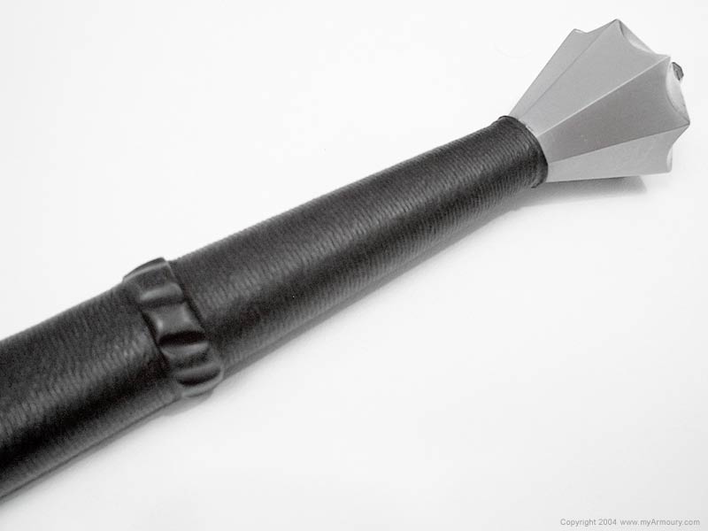

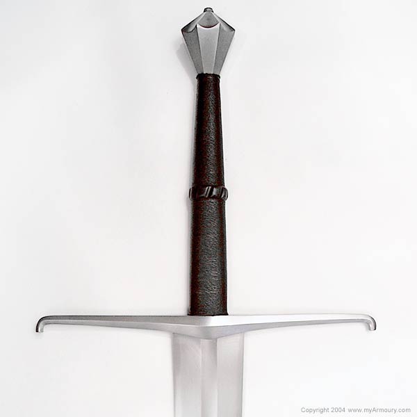

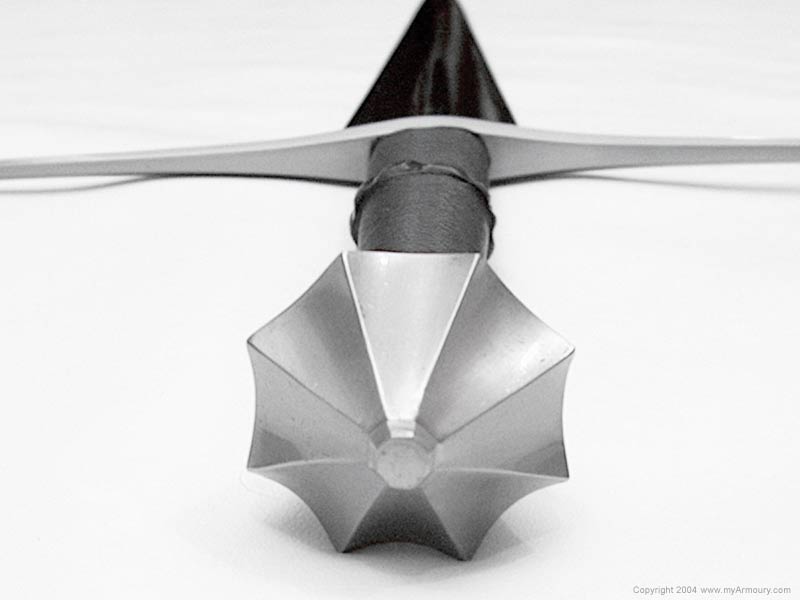

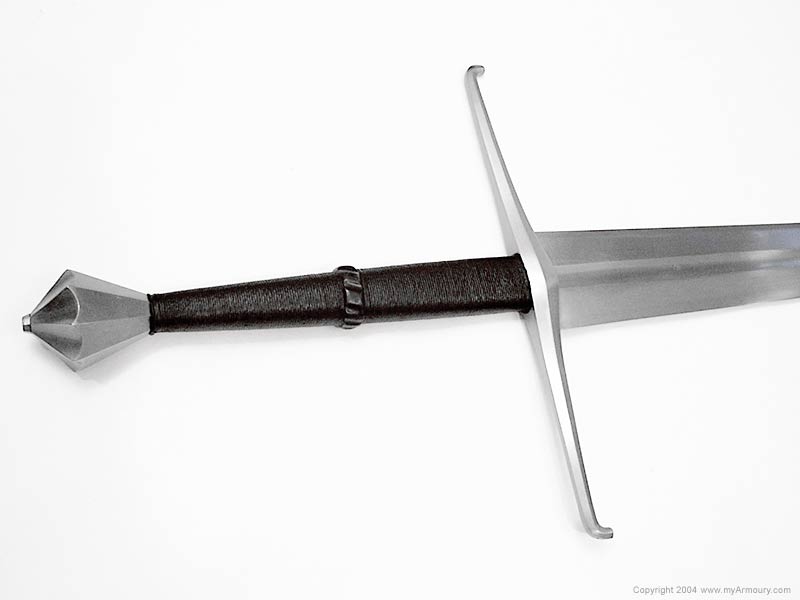

The guard and pommel are investment cast from mild steel. The casting is very cleanly executed and no pits were to be found on any of the three examples I have seen thus far. Both components feature a faceted cross-section that is very attractive, and very functional in regards to the pommel. The facets allow for several sharp angles on the pommel's end. In medieval combat, the hilt was often considered to be a weapon in its own right. This pommel would be capable of delivering incapacitating strikes to an opponent. The design of these components lends a very elegant appearance to an otherwise Spartan design.
The steel components are finished in Albion's standard satin finish that is not only attractive but easily maintained as well. The grip features a core of stabilized birch that is fitted in two sections that have been hollowed out to accept the blade's tang. This core is then fitted with a central cord riser and covered with black leather. The seam of the leather grip covering was nearly invisible on all examples of this sword that I have examined. One aspect of Albion's production method that sets their product apart from the rest of the market is their hilt construction. This feature has been covered in detail in our hands-on review of Albion's Baron Sword.
Handling Characteristics
The Brescia is simply exceptional in its handling characteristics. When using drills outlined in Guy Windsor's book The Swordsman's Companion, I found that the sword flowed effortlessly from guard to attack, and back again. The sword possesses a pivot point that is very close to the blade's tip. This allows the Brescia to follow the point extremely well during a thrust. Last year I had the opportunity to cut with this sword's prototype while using tatami mats as a cutting medium. It showed good performance on this softer cutting medium, with cuts being effectively executed and no undue vibration being felt.
At a recent Albion Collector's Guild party, Chad Arnow was able to cut with the Brescia as well and made the following observations: "This sword handles every bit as nicely as it looks. It is quick and agile. The sword's proportions (weight, balance, mass distribution) contribute to a sword that is responsive in dry handling and in cutting of light targets like pool noodles. The grip is long, certainly long enough to accommodate both of my rather large hands. The Brescia handles quite well with two hands, whether both hands are placed on the grip or if the off-hand slides down to grip the pommel. It also handles well with one hand, and is relatively easy to get up to speed when held that way. Whether used one-handed or two, it tracked easily into and out of the cut. Proper edge alignment and tip control were easy to achieve. While quick and agile, it may lack a little of the "pop," or authority in the cut, that some other swords of this size possess. I'm sure it would work well in unarmoured combat, or against lightly armoured foes; I'm not sure how well it would do against armour. The blade is stiff enough with its complex cross-section for thrusting."
I concur with Chad's observation in regards to the Brescia's thrusting ability. The blade features a shallow diamond cross-section that gives it a certain amount of flexibility that would be counterproductive in armored combat. Many other swords of the later Middle Ages feature blades with a more acute diamond or hollow-ground cross-section. Both of these designs will result in a blade that is much more rigid than the Brescia's, and thereby better suited for armored combat. It is my opinion that the Brescia may be an example of a sword that was designed more for civilian dueling than for strict military use. Regardless of its intended application, the Brescia Spadona is a sword that features outstanding handling characteristics. Any modern day martial artist will find much pleasure in the ownership and use of this sword.
