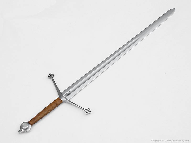

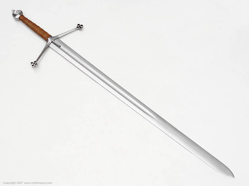

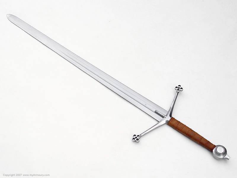

Overview
Albion Armorers introduced the Next Generation line in 2003, and with the assistance of Peter Johnsson, sought to produce swords with handling characteristics of the originals. While the Next Generation swords are not necessarily a reproduction of a particular sword, they are intended to be a true representation of the type of sword, often integrating features of several individual specimens.
The Chieftain is a fine representation of the early claymores found on grave-slabs from the early 16th century in western Scotland. Since surviving examples of these swords from this era are rare indeed, Albion took clues from the engravings and decided to build the Chieftain around the same Type XIIIa blade that is used on their Duke Type XIIIa sword.
Click to enlarge
Weight:3 pounds 13 ounces
Overall length:47 inches
Blade length:36 inches
Blade width:2 3/16 inches wide tapering to 1 1/2 inches
Grip length:7 1/2 inches
Guard width:11 3/4 inches
Point of Balance:4 1/2 inches from guard
Center of Percussion:~23 1/2 inches from guard
Oakeshott typology:Type XIIIa blade, Type J pommel
Handling Characteristics
The Type XIIIa blade is a pure cutter meant for powerful cleaving blows. This is evident when handling the sword as it has a discernible blade presence that aids in acceleration thorough the cut. However, even though the Chieftain is a big sword, it is not an unwieldy one, and with the point of balance at 4 1/2 inches the blade presence is not overpowering.
The grip is slightly longer than the Duke's, by 1/4 inch, though the overall difference in weight is where the difference in handling comes into play. The Chieftain outweighs the Duke by 9 ounces with the all of the additional weight distributed in the hilt furniture. The slightly longer grip paired with the added weight is pulls the balance point back to 4 1/2 inches in the Chieftain compared with 5 3/4 inches in the Duke. This makes for a very responsive sword particularly in two hands. The long grip makes use in two hands natural, though the balance is such that the Chieftain can be used in one hand. It may be more useful in one hand when used as a cavalry weapon, using the momentum of the steed to aid in dealing powerful blows.
While not intended for quick directional changes or sudden stops, I found the Chieftain to be more agile when using two hands rather than one. The Chieftain certainly builds momentum in the swing that aids in tracking. Looping a finger over the cross aids somewhat in tip control, but since this is not a cut and thrust weapon, tip control is not much of an issue and this detracts somewhat from the power of the cut.
I found it comfortable to grip the sword with both hands on the grip or alternately with one hand on the pommel. The Chieftain performed well against the light targets with which I tested it (milk jugs and pumpkins), being effortless through the cut, with no vibration at impact—literally slicing through light targets as if through air.

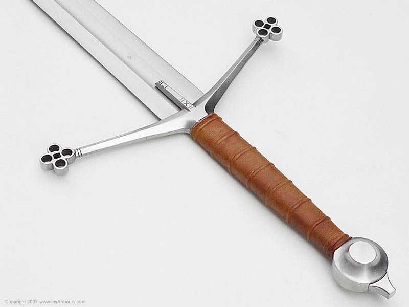

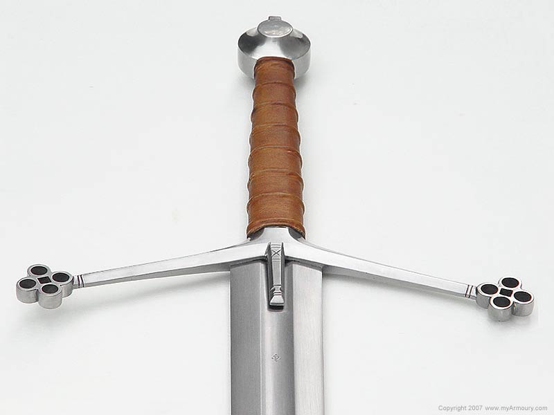

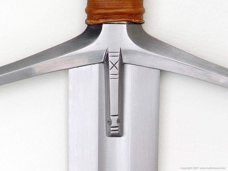

Albion hits another one out of the park with the Chieftain. The pommel and cross are investment cast in mild steel with a satin finish. The fittings are tightly fitted to the tang, typical of other Albion offerings.
Click to enlarge

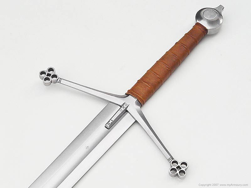

Detail of langet
Click to enlarge

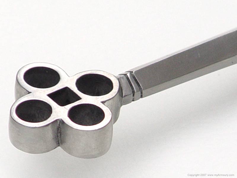

Piereced quatrefoil

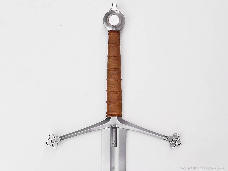

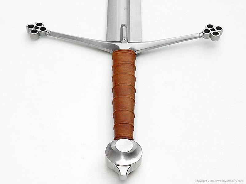

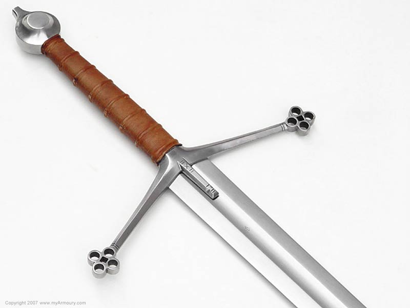

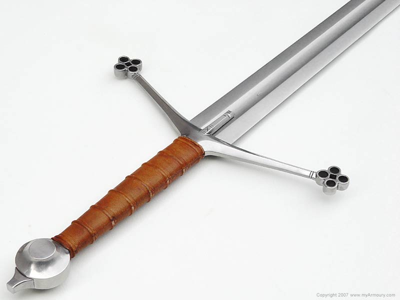

The pommel is Type J with a long and sloped pommel block, a fine depiction of the teardrop shape that is noted in period artwork for this type of sword. One's eye is immediately drawn to the sloping quillions ending in pierced quatrefoils. Albion chose to cast them as part of the arms rather than welding them onto the ends, finishing all of the castings with small sanding discs and by hand over the course of several hours. The langet and quillions are incised with double lines just medial to each quatrefoil, and double lines and X's on each langet, following examples found on originals. The lines on the langets are not quite plumb, and appear to be done quickly by hand—even differing slightly from side to side. While this may seem odd to modern sensibilities, I find it reminiscent of the slight asymmetries typical of historical swords and do not find it to be particularly bothersome; in fact, I find that it increases the character of the piece. Near the distal end of the langet are two "scooped" depressions which are very reminiscent of the "eyes" seen on Celtic, Viking, or Anglo-Saxon dragon or animal representations on weapons and armour, though these decorative fileworks are found on objects from the early Iron Age through the Renaissance.
The grip is of the Albion campaign-worn light brown leather over a cylindrical core of stabilized birch. It has risers spaced every inch, which makes for a very comfortable grip. This allows for a very stable grip, whether holding tightly next to the cross, at the midpoint, or next to the pommel. This stable grip aids in handling, as there is less chance of slippage during maneuvers with one hand or two.
